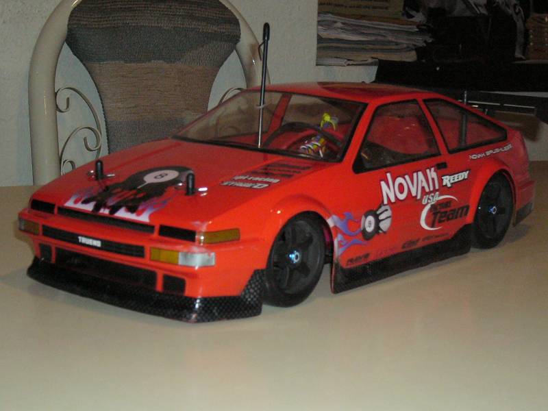

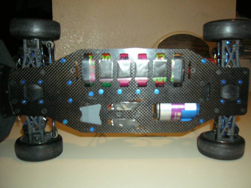

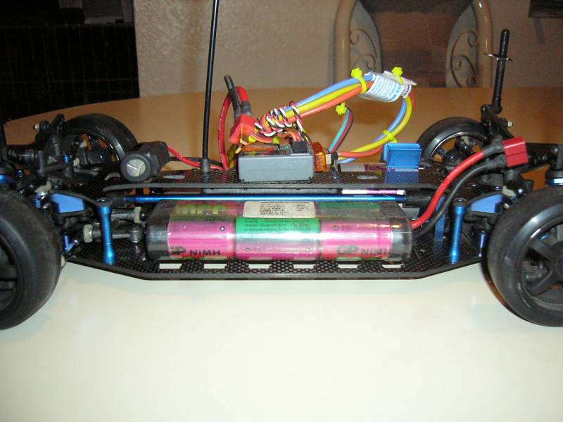

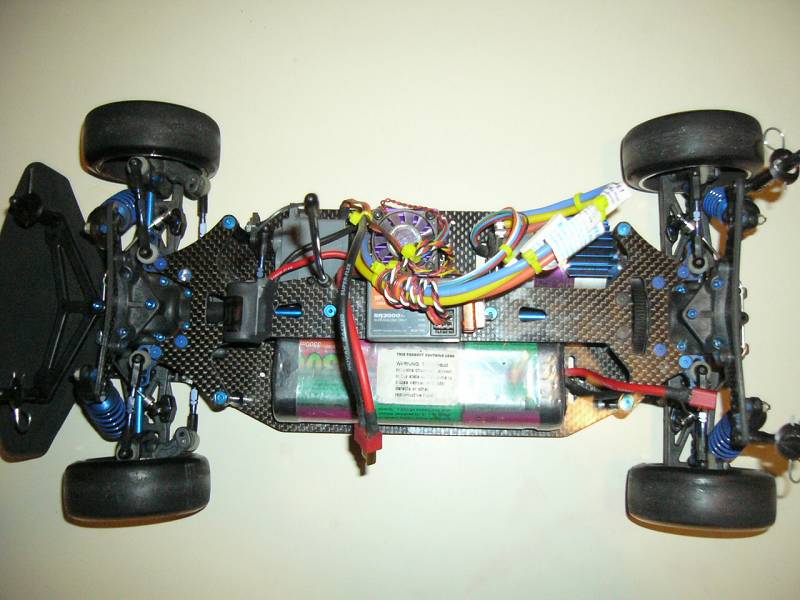

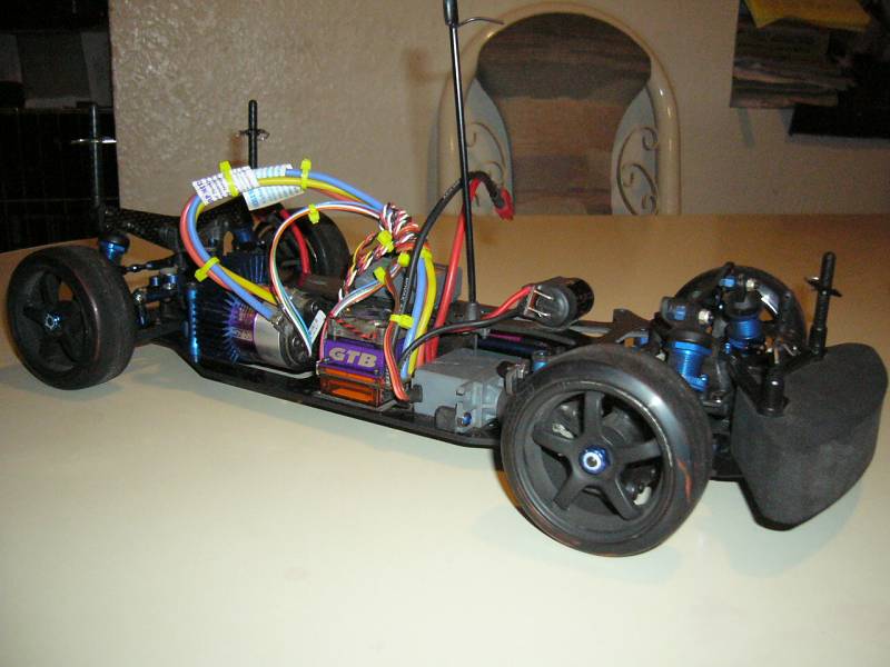

My drifter is a Team Associated TC4 Factory Team Kit. It has a Novak Velociti Race-tuned Brushless motor 5.5 turn and with a GTB Brushless Racing ESC. The tire's are HPI D-stage drift tires they work REAL good.
WHAT DO YOU THINK ABOUT IT.

your toe in settings are a little unusual for drifting arent they?
i could be wrong though but i thought its best to have no toe in rear or front?

Wrong, that toe with plastic tyres is needed, rear toe stabilises the back end, front toe-out aids steering

That ae86 body is killin 'em; it deffinently looks good but does it drive good?

I thought a 5.5 Might be a Bit Quick for Drift.. I tend to stick with motors above 19Turns... More Torque less speed... Just what the Doctor Ordered to get the Tail Out lol !
