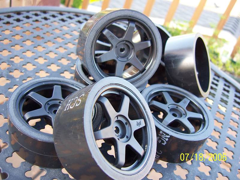

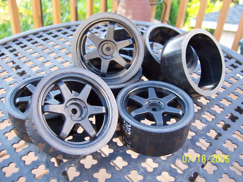

I can't wait untill my car gets here tomorrow so me an my friend decided to throw some wheels and abs on his lathe
here is how they turned out, the abs slips on and is quite snug
just for extra protection we are tacking the abs on the back of the wheel with hot glue to the rim so we can change the abs tires that we made easially
let me know what you think

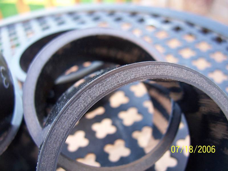

you can find ABS in a local hardware store such as home depo (find the pvc and the black stuff next to it is abs it really isn't that hard)
and sry that I haven't checked the forums in a while I just bought a new airbrush and painted my first body
and to answer the question of how we cut the abs
LivingLegend has a workshop so we used his horizontal bandsaw to rough cut the size then we threw em on a metal lathe to get it down to the exact width
and depending on the wheels you have you might need to sand down the edges, the hpi ones I got we had to lathe down a little bit to make it fit in the ABS but the wheels that came with my TT-01 slid in and fit quite snug

Default RE: First time ABS wheels
i would sugest not usnig hot glue to mount the abs, rather put tape around that acuall rim then smack the abs on the outside with a rubber mallot, i used the hotglue method when i first mounted my whells, and it worked for aobut 5 mins then my left rear flew off. it was also my first time runing the car. lol

ya hot glue it a bad idea because those wheels will heat up and melt the glue off easy... could CA glue be used then just some nail polish remover to get it off???

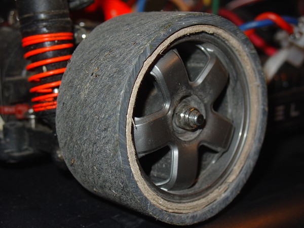

Here's my ABS tires
Old 07-23-2006 | 03:41 AM
ITB4ag's Avatar
Joined: Jul 2006
Posts: 4
From: Gresham, OR
those look nice f150 what did you do to mount them?
and on the whole hot glue thing it works really well if you put the glue on underneath where the ABS goes before you squeeze the ABS on I have been using/abusing mine for a while now and they haven't come off
