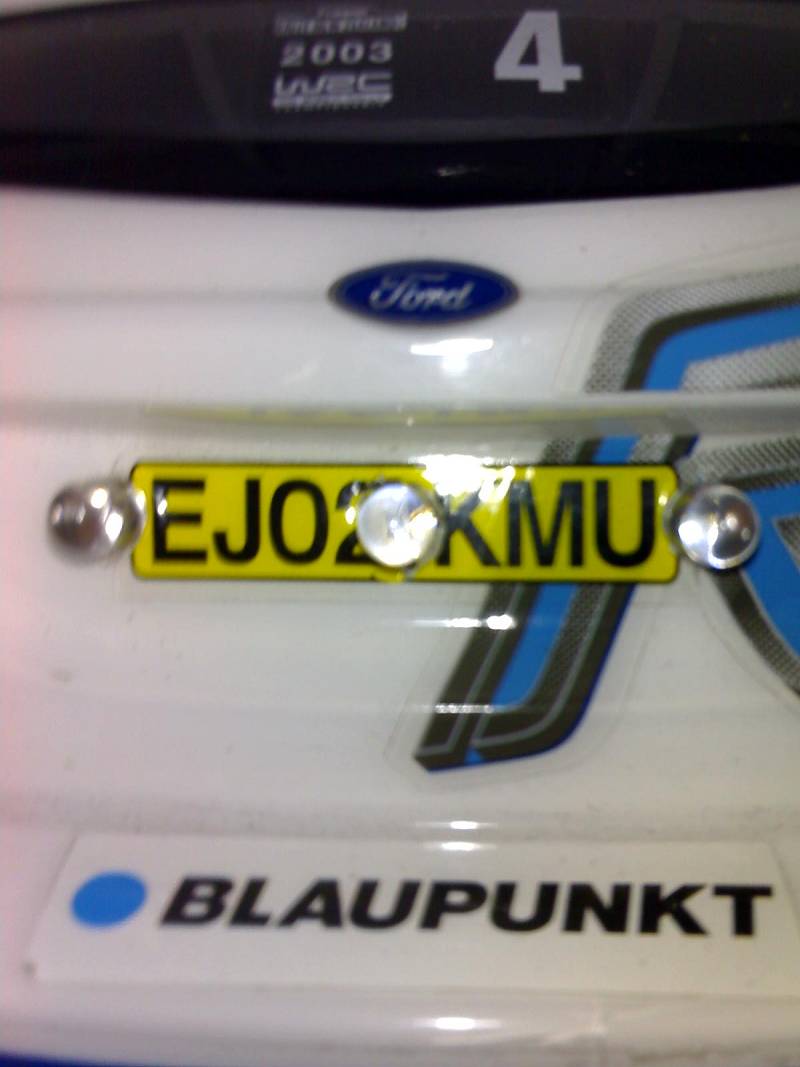

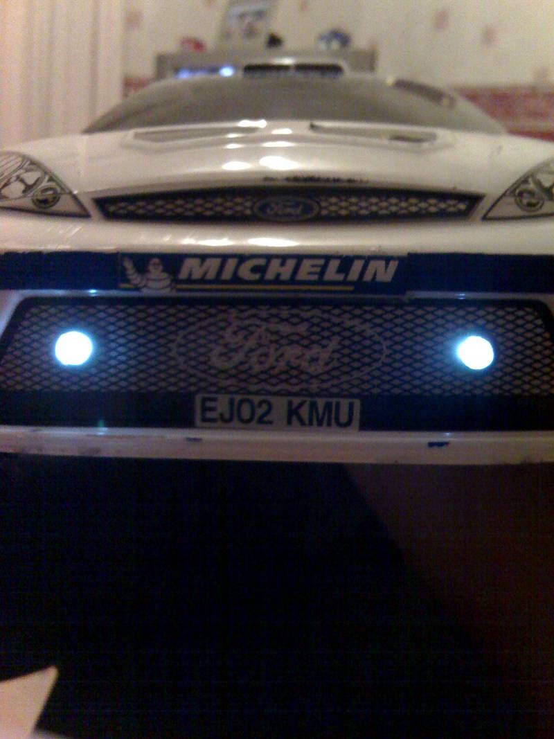

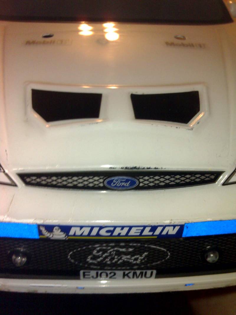

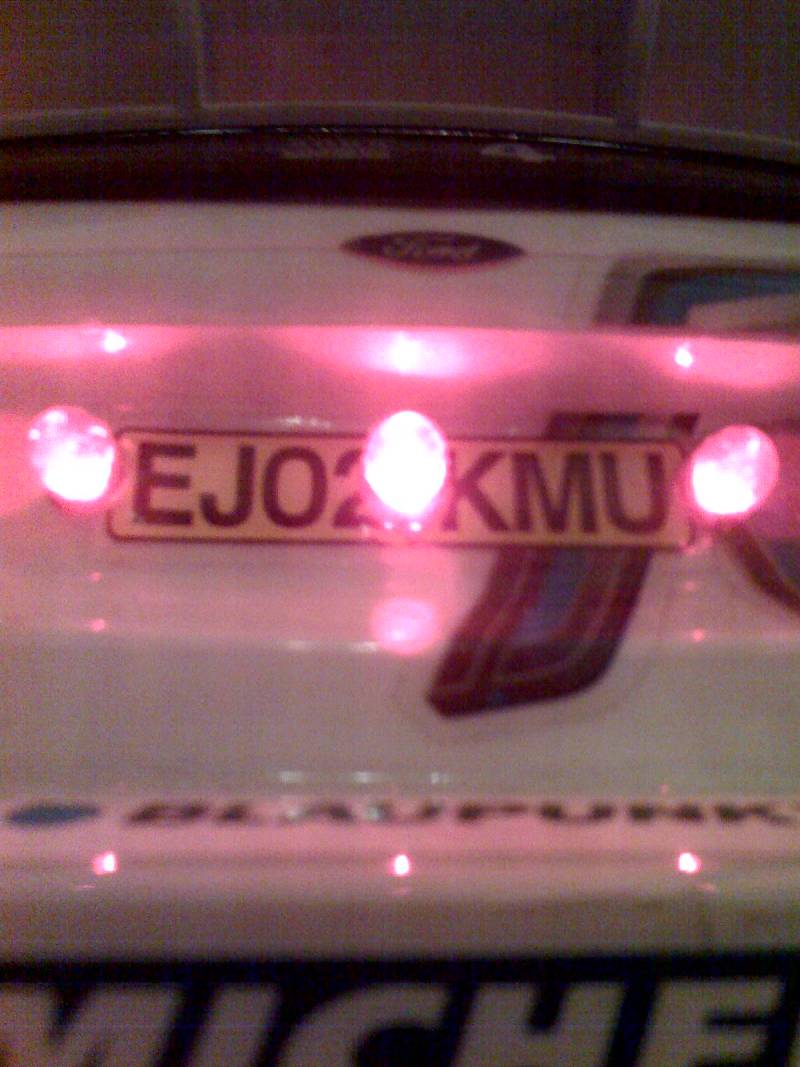

thanks mt , i just wish i could get a better video , the one posted doesn't realy do them justice , any chance of seeing your lights , what have you used, just had a thought , gonna try the video mode on my dig cam
try this one
http://s205.photobucket.com/albums/b...nt=Picture.flv
apoligies for picture quality , my camera batterys died after the video , had to use my phone

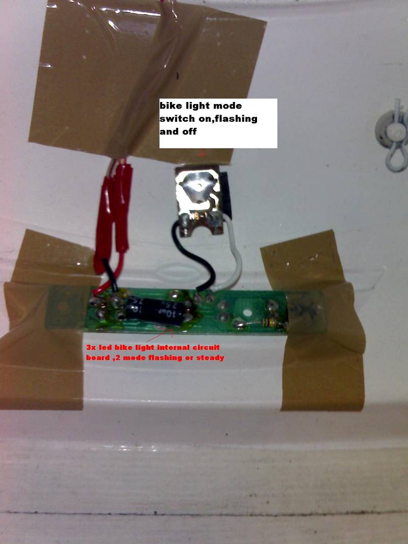

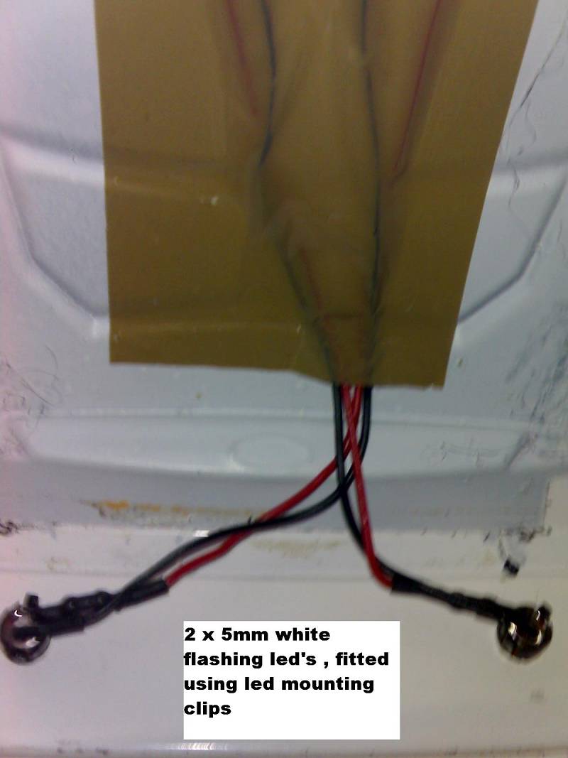

just added pics to go with video , and explanation on how i made them
