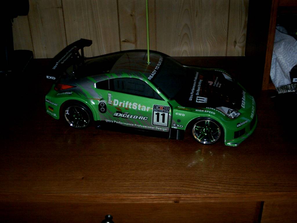

Default Dift car out of control on pavement
On pavement the tires spen almost all the time will not let it get to top speed in straight line. what to do. New at this.All over the road.

Default RE: Dift car out of control on pavement
I'm pretty new myself and have found that you can't just expect the car to take off full throttle with no grip. You have drift tires on so your not going to get traction for speed. If you want that you need new tires that will give you grip. Drifting is not about speed from what I have seen and atleast for me I only use half throttle max..
Welcome to drifting.
If the wheels aren't spinning you aren't drifting your driving
If you want more speed, try different tires. Also just learned to control your throttle..
less throttle is more with plastic tires, the less speed difference between the tires and the ground the more traction the car will have. my first stock tires on my xxx-s drift-r were a hard rubber compound and it was really hard to drift, then i tried some cut ABS pipe, and i broke a rim (not a strong setup on rough concrete). i now have some ones that have a plastic center with rubber sides, and came on really strong rims that have taken a serious beating as i like to go from sidewalk to parking lot as a transition from time to time lol. these are the ones i bought, dirt cheap too. http://cgi.ebay.ca/ws/eBayISAPI.dll?...MEWNX:IT  and he's got lots of other rim styles too.
Check the tightness of your servo saver what is your chassis type and brand?
thats an exceed drifter.
looks like a HSP car?
I assume its brushed then? if you bought it as a drift car?
does it come with plastic "tyres"?
