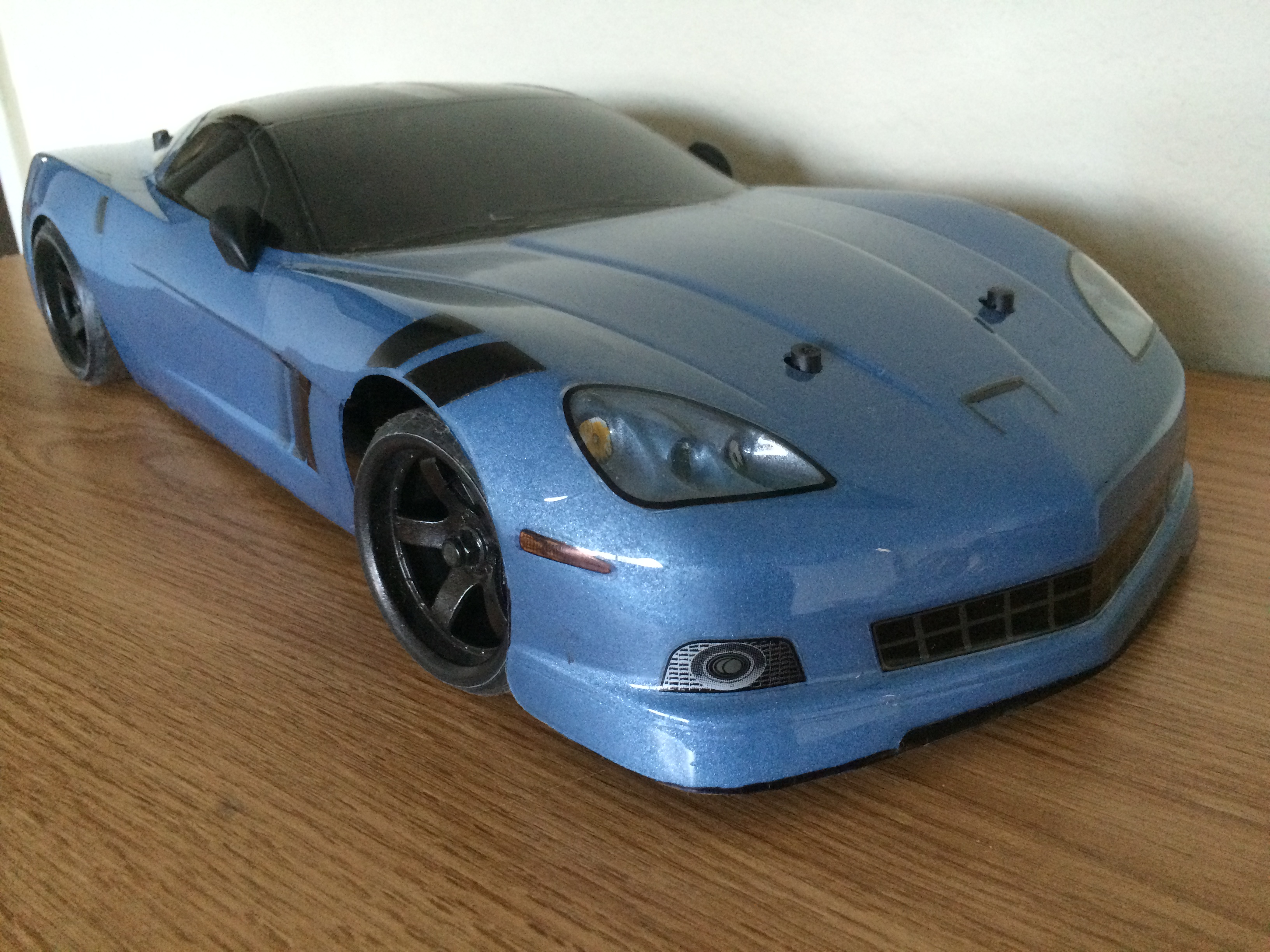

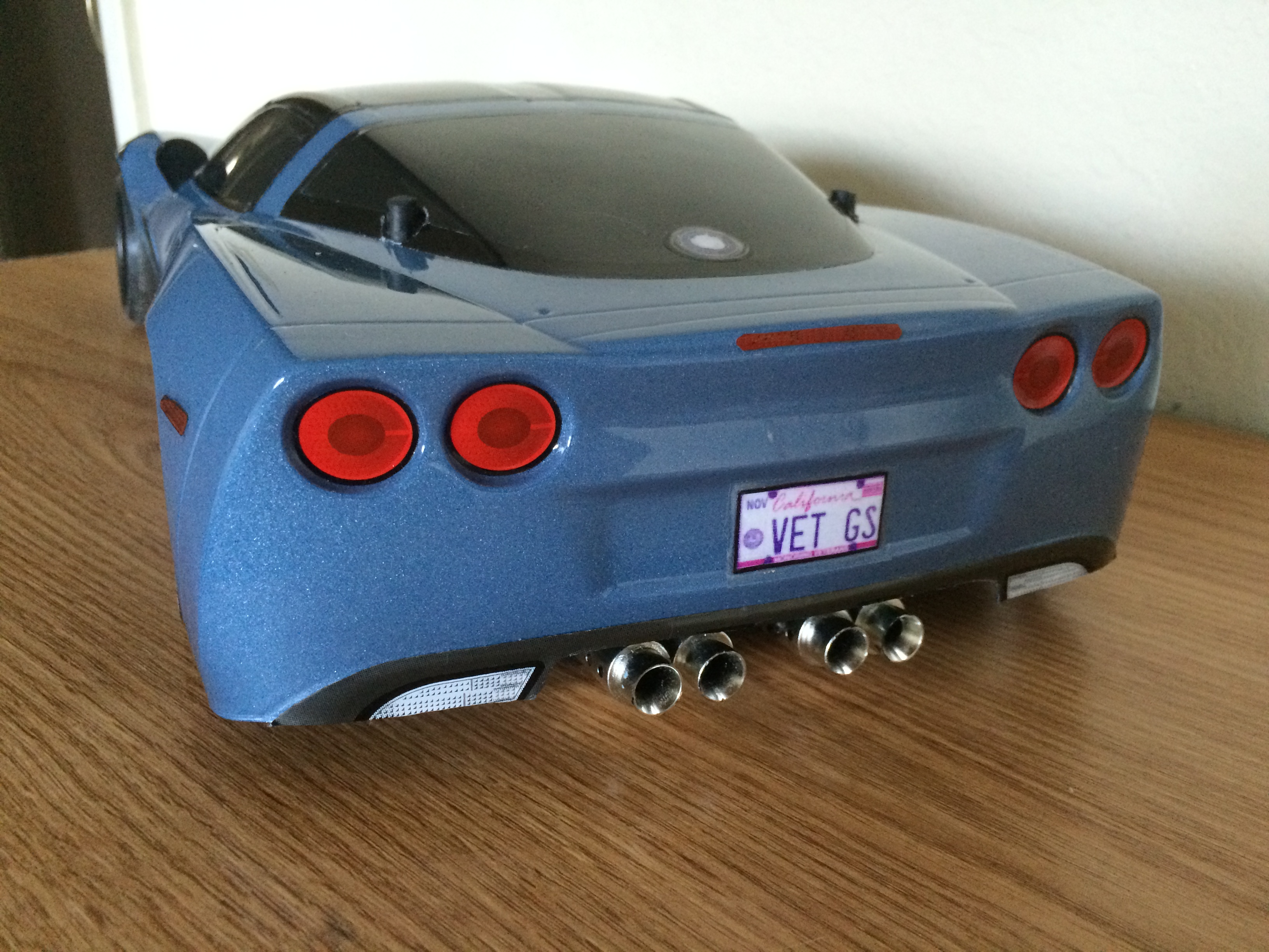

Mine is a Brushed motor model I was given for Christmas. I have a Bushless Hobbywing motor, ESC and 5000 mah Lipo coming.
This is my first Drift Car so I can't compare it with others. So far it is easy to learn on. I is fairly fast. I was surprised.
My only complaint to date is it has many machine screws that are threaded directly into plastic and have a thread locker on them. When taking a couple of them out, I think the threads came out with them. I have use the next longer machine screw to repair those. I might have to go one diameter larger if it becomes a problem.
My mods to date are:
1) Locked rear differential. Much nicer to drift with.
2) One way front differential. I did not like the feel so I put back the stock one, that feels best to me.
3) Moved the steering arms to the inner holes on the front spindles. This allows the front wheel more turning angle. The tie rods had to be extended and I trimmed a small amount of material from the spindles where they hit the lower control arm.
4) I put a 200 mm Corvette body on this 190 mm chassis.
5) Installed 6 mm off set wheels with 5 degree drift tires to fit the new wider body. I had to trim a little more from the wheel openings to allow for the greater swing radius.
6) I raised the ride height slightly for the rough surfaces I have to run on. The front of the body was catching on cracks.
7) I bought a Thunder AC6 battery charger. Original 2000 mah NiMH batteries last 20 minutes on a charge.

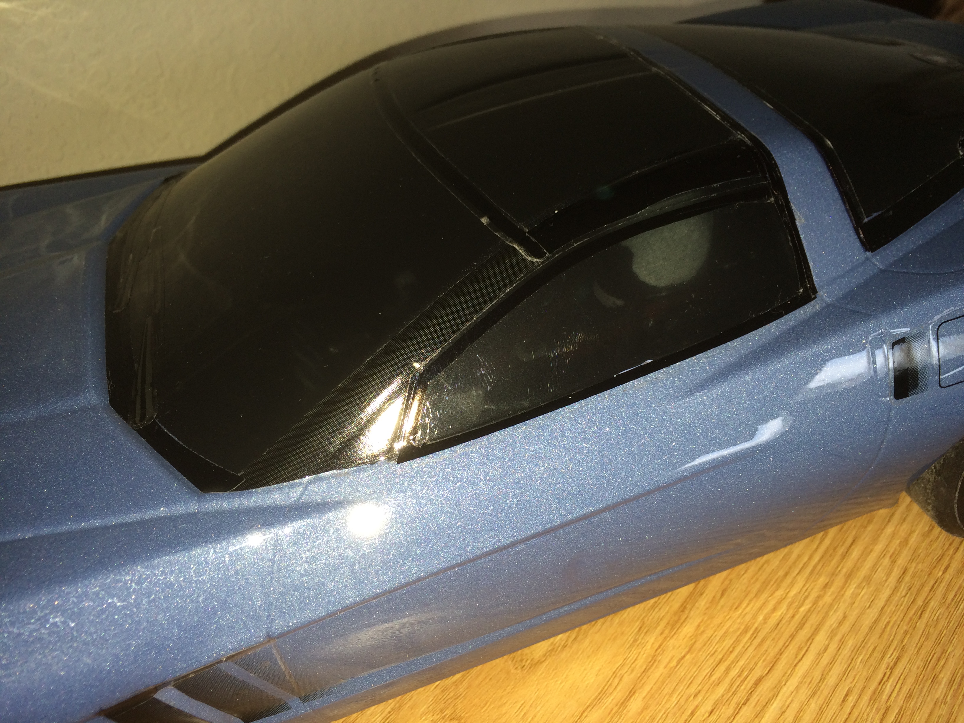

8) Forgot to mention, I bought an inside drivers compartment model, from Sears, that can lightly be seen through the tinted windows.
