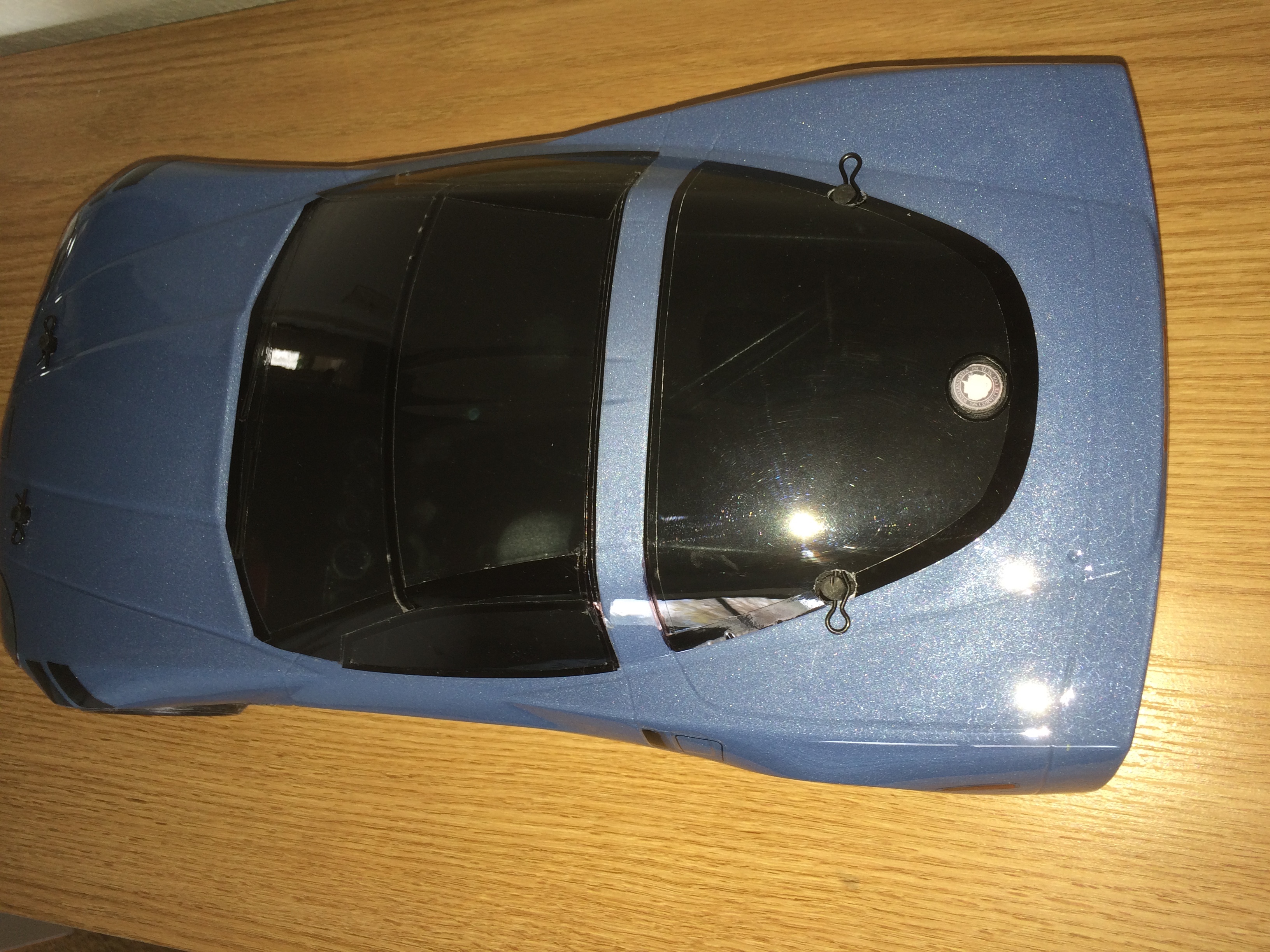

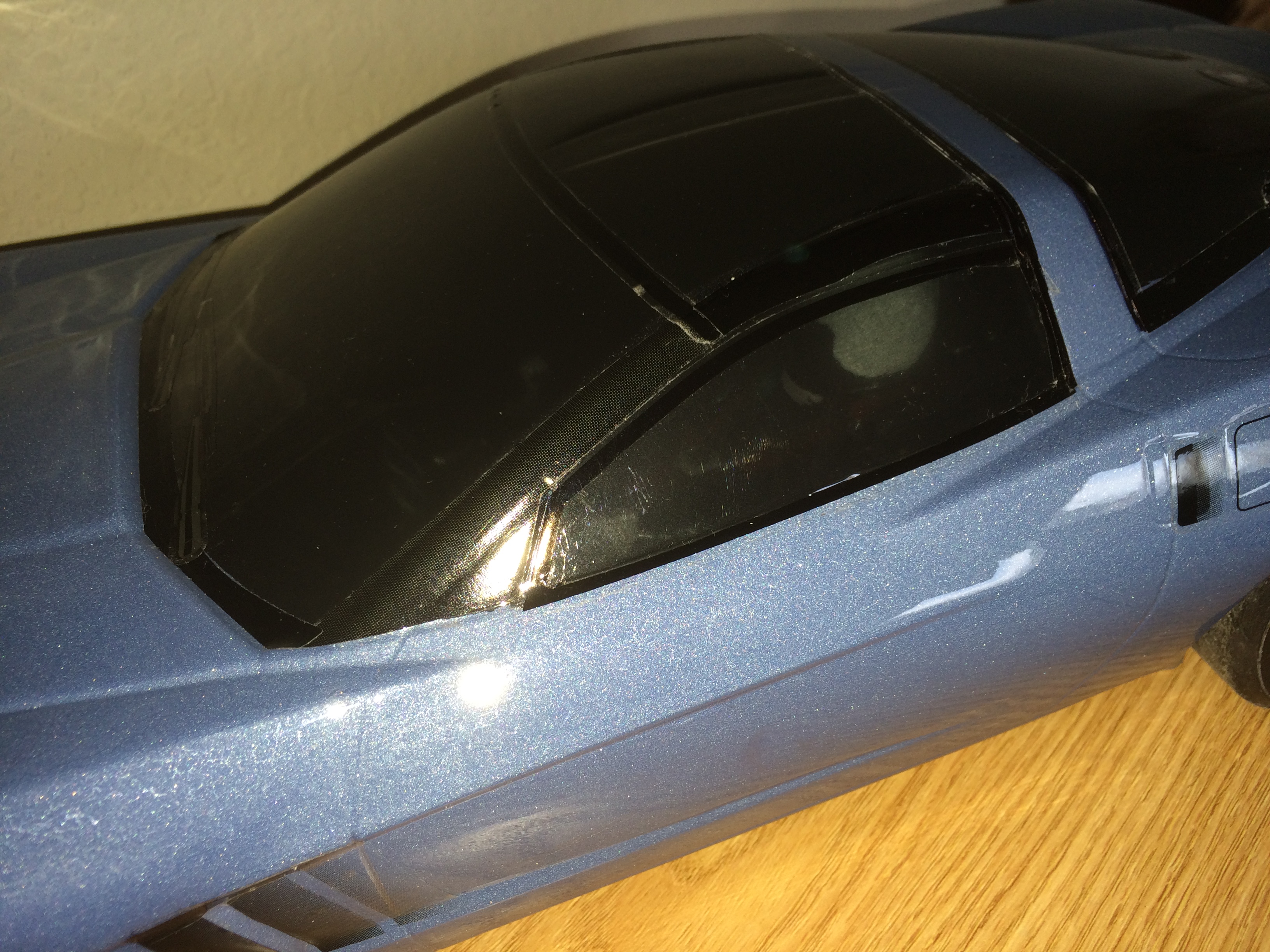

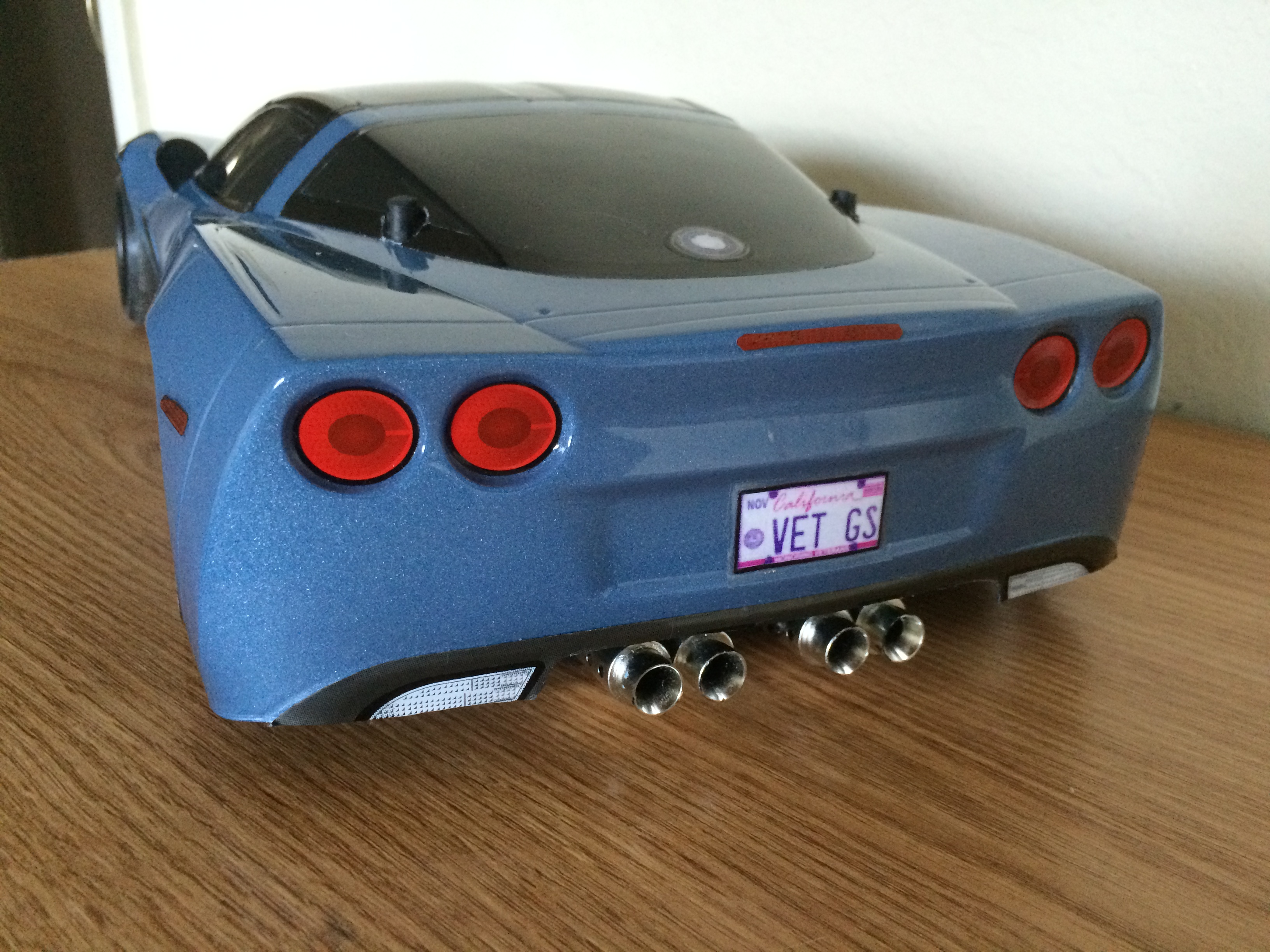

4) I put a 200 mm Corvette body on this 190 mm chassis.
5) Installed 6 mm off set wheels with 5 degree drift tires to fit the new wider body. I had to trim a little more from the wheel openings to allow for the greater swing radius.
6) I raised the ride height slightly for the rough surfaces I have to run on. The front of the body was catching on cracks.
7) I bought a Thunder AC6 battery charger. Original 2000 mah NiMH batteries last 20 minutes on a charge.
8) Forgot to mention, I bought an inside drivers compartment model, from Sears, that can lightly be seen through the tinted windows.
The camera makes this color sparkle more than it appears in real. It is very close to my real car.

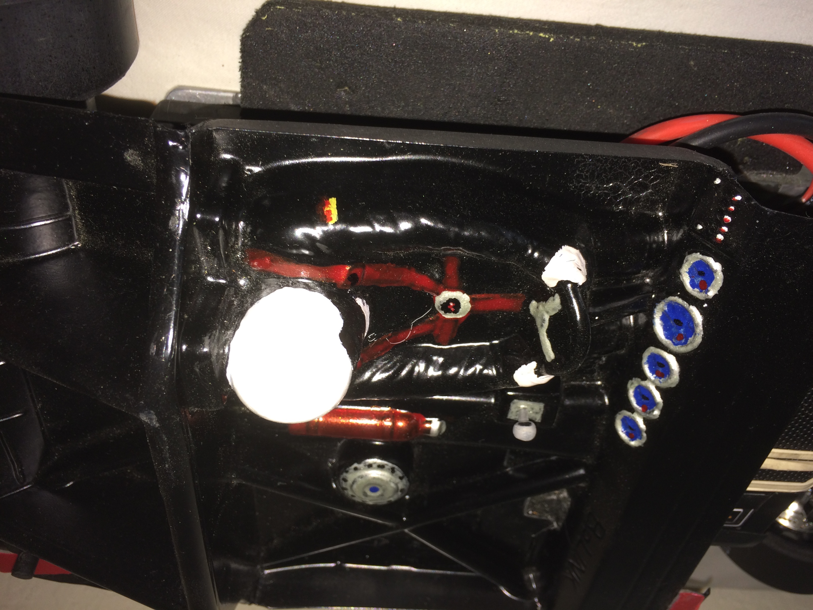

My mods are completed now.
I have upgraded my suspension with aluminum control arms and steering components. The front arms are HSP that I shortened 7mm each. The rear arms I made from scratch. The steering components were each modified to fit my application. I made a full frame pan to replace the plastic pan. I made the front suspension mount removable for ease of future modifications.
I have a Hobbywing 5.5T EZRun Brushless Motor with a cooling fan. I have a Hobbywing 80a ESC with cooling fan. I installed a Solar High Speed (.06 sec) Servo and modified the geometry of the steering angle for max tuning. I have a locked rear differential and a one way front differential. I am using a Venom 5000ma Lipo. I made my own ABS tires. About 5 sets for $3. They are perfect on smooth surfaces. I have a set of soft grip tires for speed runs. For drifting in parking lots I use a 64/13 gear ratio. For speed runs with grip tires I use 64/27 that gets about 50 mph. The motor gets up to 170 degrees fairly fast. It would be better for me to have a 120a ESC. Get that later. I am good with the drift gears for now. I have a ESS Sound Simulator Box that make it all seem real. I bought a scale driver and interior from Sears, of all places. My car looks just like my real car and it attracts a lot of people when I am out in public especially at the Race Track. The real Race Track parking lots. Everybody loves toys.
I will try to post as many photos as I can. There seems to be an issue between this web site and my Mac Computer.
I need help if someone knows what to do.
My Photos all post up/side down. So I go to my computer photos and turn them us/side down first but they still post here, up/side down.
