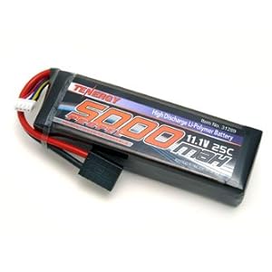

What do you think about this battery?
Tenergy 11.1V 5000mAh 25C lipo

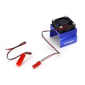

And will this motor cooler from integy be good enough??
http://ecx.images-amazon.com/images/...500_AA300_.jpg
gokemidoro 07-11-2011 07:06 PM
RE: whats wrong with the hpi e10?
Whoa, dude!
At this pace, you might as well get a higher rated chassis! With all the parts you have listed, you can get a TA05, or at least a model with more option parts on it. TB03D? Or a mid-level TC chassis that will convert to drift (most TCchassis will).
At this point, what you are contemplating may be too much, even for the TT01. It sure sounds like it.
Try looking around, and I'll bet you will find a higher rated chassis for a great price. Iknow of one already - the Ofna JL10e TC chassis (the shaftie, not the drift). It's a roller, and costs $120. Electronics are needed, but the roller is so affordable, it will allow you to do as you are contemplating and be able to take the punishment (Ihad one, Ican attest to it's durability), and it does well in drift, even better for grip. It comes with grip tires, so the Raikous are still needed, but you will see just how well made the JL10e is, compared to the TT01. Ofna's #1 driver, Jeffery Lin has won races and titles with that chassis. Forget option parts with the JL10e - it doesn't need any! :)
It's the best alternative to the TT01 I can find, and it's price is a draw. Imay get another one, for RCGT.
So rethink what you are after. I'm trying to save you trouble and expense, and steer you to something that will grow with you, and not cost an arm or a leg.
On the parts you listed, the battery is a 3S. You will have to check the power system you plan to get and see if it is rated to take more than 12V input. For most apps, the 2S is plenty. The cooling fanis always a good idea, but some power combos come with fans, But Iwould get one, only if Ineeded it. If you gear correctly, you won't need the fan.

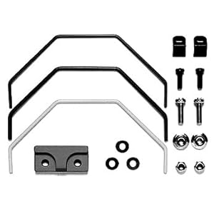

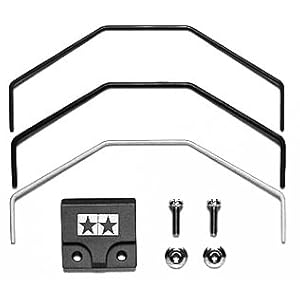

Also will front and rear stabilizers benefit the car?
gokemidoro 07-15-2011 09:11 AM
You could put them on, but I find it a waste of time. They are actually more beneficial for grip racing, but not much else. If you plan to do some grip driving, you could mount them, but not attach the armns to the springs when drifting.
