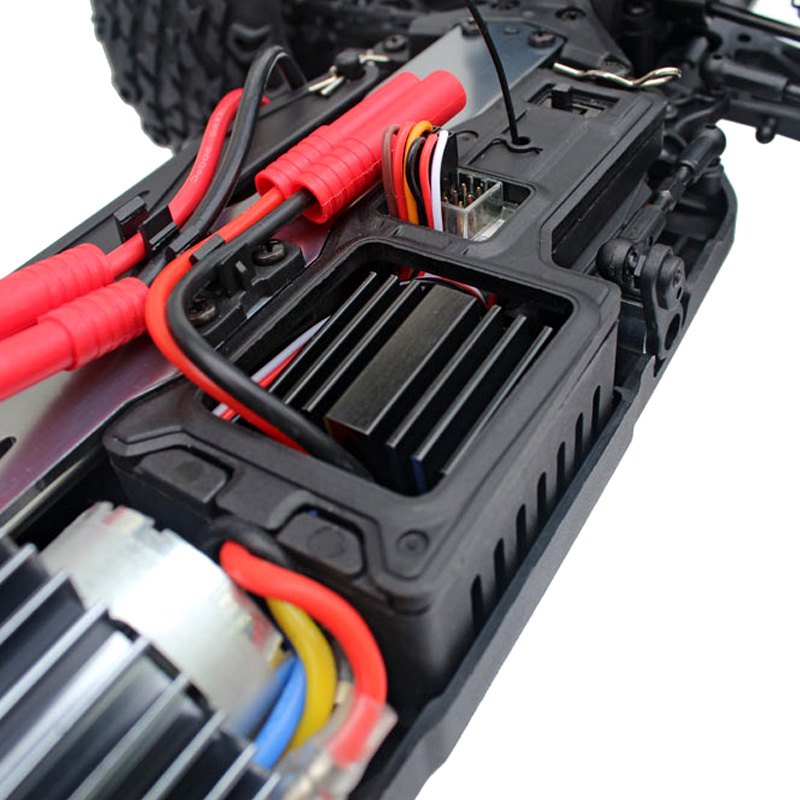

I see where the length of the can could be an issue now. Earlier I said about using Dremel tool. That was on another Redcat/Exceed/HSP chassis.
