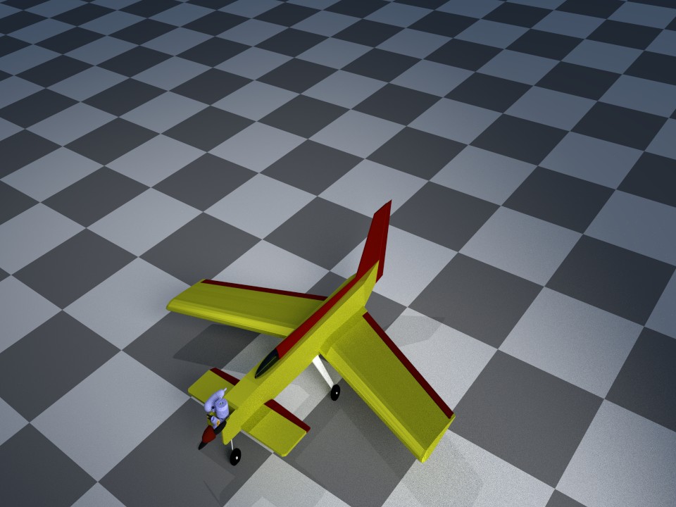

Hi, I am looking for help with the phoenix builder software that came with version 5. I Made the model I am working with in blender 3d software. The builder software wont accept the file I output from blender. It seems to import all the geometry but then nothing shows in the window even though its all listed. I found a way to import it into a trial of 3ds max then export in the same format I tried with blender. After numerous applications of my forehead to the computer desk I finally got the model mostly setup and into Phoenix. The first time I had no materials on the plane and couldnt figure out how to get them into the sim. After more application of forehead to desk I got some color on the model. My problem is that the rudder does not display properly. Instead of rotating on the back of the fin as it should, it seperates from the fin in an arc vertically into the ground and over the top of the model. I am new to 3d modeling and the only reason I got into it was to be able to fly this model in a simulator. The model is called a Sweepee. It is a forward swept wing canard that I had built and flown in the early 90s.
thanks
