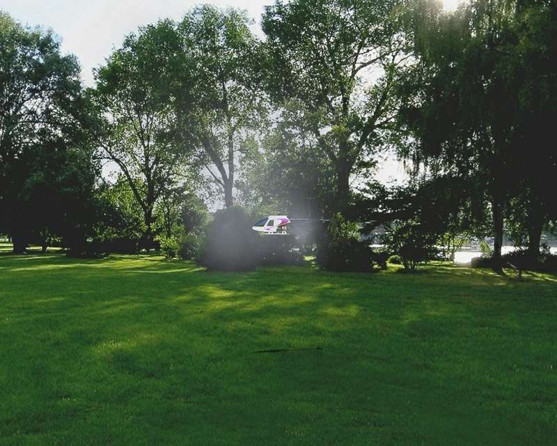

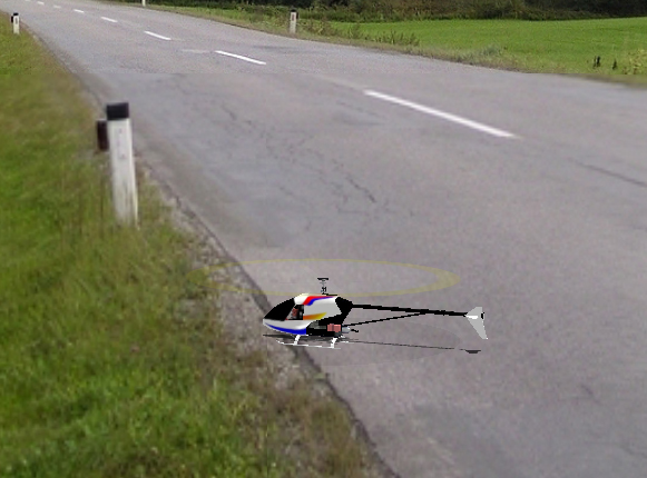

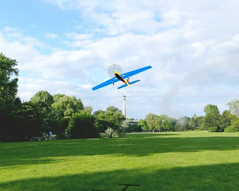

Hi simmers
Just one of the new planes at rc-sim. The "RUBIN"
Regards Dave

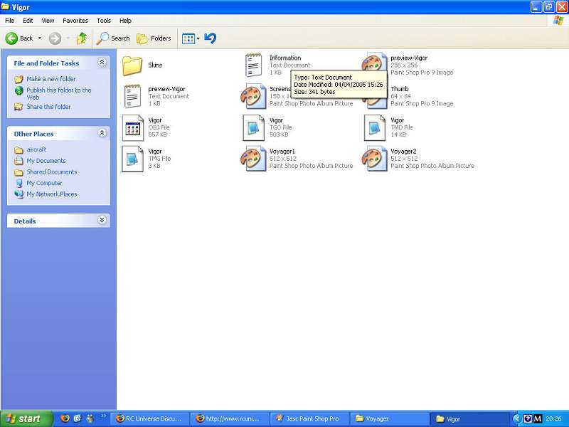

And a JR Vigor and Voyager. Very nice to fly but i cant seem to get the skins working

Hi eddible
just d/loaded voyger and there are 2 folders make sure it all goes into one folder and delete the empty folder
this worked for me.
Just done the vigor same as above.
Regards Dave.

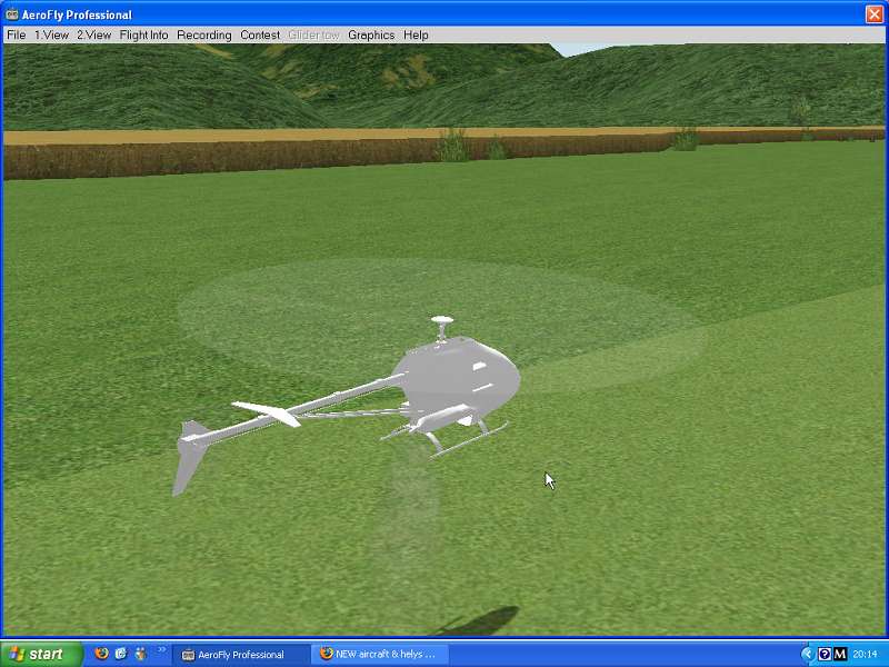

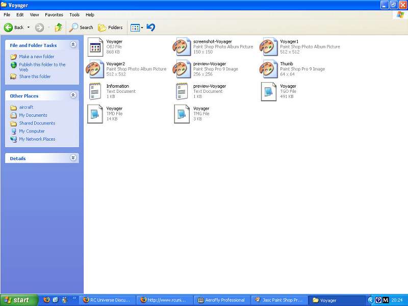

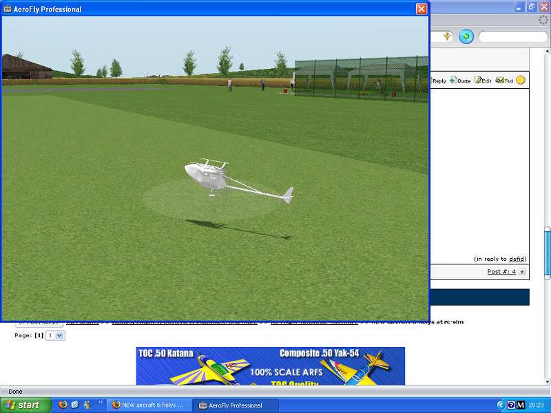

This is what i get [&o]
pic1 is the vigor pic 2 is the voyager and pic 3 and 4 is what is in the files
there still fun to fly, even if orientation is a bit difficult

Eddible
Try changeing paint shop pro pallets to bmp files.
ALSO JUST NOTICED IN 4TH PICTURE UP IN LEFT HAND CORNER ARE THE SKINS. If this folder is empty delete it.

Dave
the SKINS is just a file with spare skins in it, 3 diff colour schemes. i converted to .bmp no change. went into the .OBJ file, changed the name of the skin file to a .bmp, nothing
ta,
Ian

Eddible
just did both d/loads again, d/loaded to my desk top unzipped folder opened the other folder inside the first folder copyed all then deleted the second folder then pasted all in first folder closed it then i ran it through the conversion tool and it worked for me again.

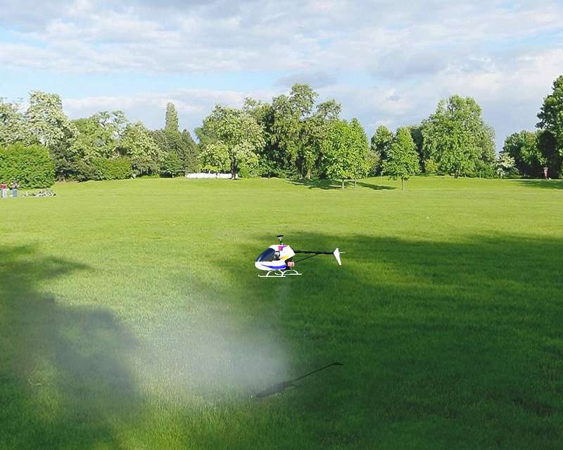

keh keh here is that voyager in AFP with fully textured!

Here is how:
1. Convert ALL Jpg files to 24bit BMPs
2. Open the .obj file in Notepad
4. Save the change, close the file
5. DELETE the .tgo file
6. Start Aerofly and ... whala! there it is, textured, colored,
Old 04-06-2005 | 04:12 AM
Ian.W's Avatar
Joined: Jun 2003
Posts: 4,285
From: Essex, UNITED KINGDOM
Default RE: NEW aircraft & helys at rc-sim
thanks moo, i got it working. now i cann see which way it goes[&:]
