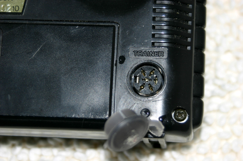

P-diddy will this AFPD 31047 adapter work with my older FPT7UAP Futaba radio? Thank you Max1

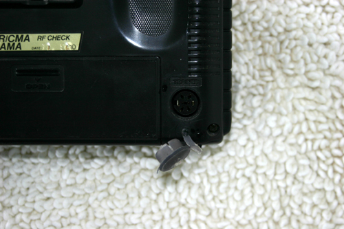

Hi max, can you post a photo of the connector behind your radio? For older Futaba radios, it could be a DIN6 or DIN5. If it is a DIN6, then that adapter will work. Then you will have to set your radio to PPM mode as per post #2 above.

Max, thanks for the pics. It is a DIN6 connector and the adapter will work

Max1,
Did you get it to work? It really should work with AFPD just as easily as with G3.x...
The main thing is finding out how to change it from PCM to PPM. If you can get a hold of the old instruction manual, that will explain how.
