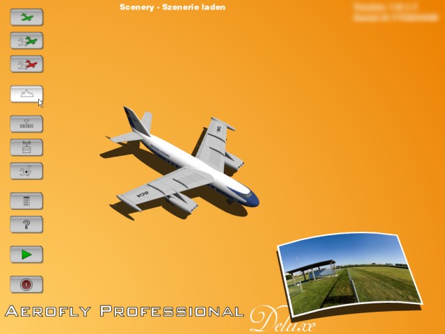

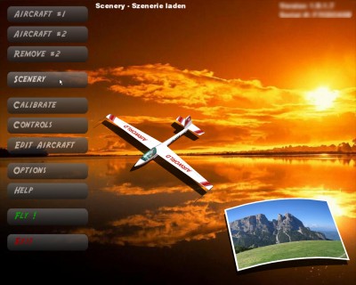

Hi folks,
as rotemarie posted in [link=http://www.rc-sim.de/wbb2/thread.php?threadid=2358&threadview=0&hilight=&hil ightuser=0&page=1]this thread[/link], you can skin alot of AFPD's graphics.
With that you can change AFPD's look completely! See the pictures!
Cheers,
Lego

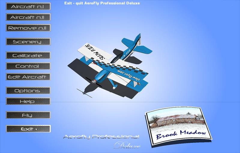

It works well.........................

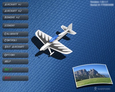

Old 03-19-2006 | 01:44 PM
Joined: Mar 2005
Posts: 123
From: Cologne, GERMANY
Default RE: Skinning AFPD
Hi Greg,
the thin line is only visible if the screen resolution is larger than 1024x768. It must be something inside AFPD causing this.
I played around with some icon-buttons. AFPD then looks much better. [8D]
Greets,
Lego

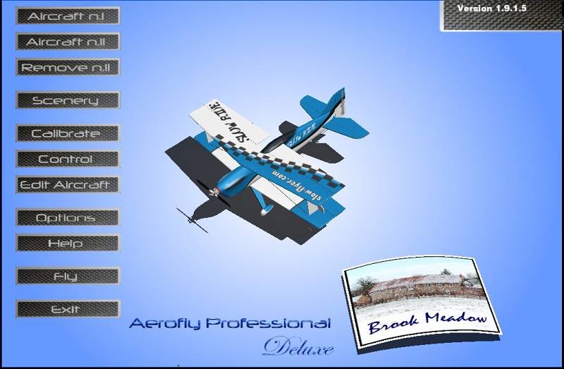

Ahhhh...I see,
Lego: I wonder if you could please tell me how you convert your bmp/jpgs to TMT? Can you use the "afpdjtof.exe"?
Thanks!
Greg.
I've finished my "Carbon" theme for AFPD!

Another one.....................I like Carbon Fibre!
