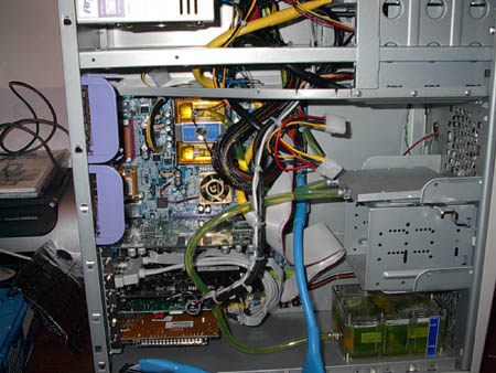

A good computer to run the simulators?
I can send you links-I prefer via Email on sending you links not online..
I would not get a video card with onboard shared memory...I tried one of the mobos with it and sound & on-board Lan it was a bit slow to me..
I run RealFlight on this lil rig now:Staying on subject I use it with Realflight If you need advice-PM or Email ...I do not want to get to off topic..in forum..
P4 3Ghz+Non Overclocked-Water Cooled Video-HD-CPU w/radiator RealFlight Rig
