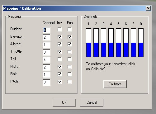

K- i have this Futaba T6XH transmitter- and i am playing with FMS.. I just got the usb cord so i can use it- but it needs to work as a joystick setup i guess.. but thats fine.. heres the newb QUESTION,,, I have
Rudder= ch1
Elevator=ch2
Throttle=ch4 and that seems to control ch6 too- so i put
Pitch=ch6
now this works almost fine- except i cant swing the tail)... and also that set up is
leaving me with Aileron,Tail,Nick,Roll not spoken for -- now also for some reason the left stick on the trans)throttle stick) nothing happens when i move it left and right... Im prayin soemone can help me here- goin crazy with thtis. maybe give me the correct layout of what it should be - and if certain things should be on the same channel or something??
Thank you so much in advance..

Here's the setup I'm using with a old analog futaba- should be the same assignments as a 6X Try differnent inverts

i have all the controls set.. except for being able to roll back and forth with the left stick (side to side) .. everything else works.. i think i read somewhere that joystick config has limitations of channels or something... saw a bunch of how-to's online but for some reason they are able to get there usb connect as a com port in device manager- wich i am unable to do-- from there i think they use the pic-serial option in fms... i dont mind using the joystick mode now that i almost got it- but how do i get my left stick to work???

just to be clear......... my left stick works for throttle- but not side to side.

Left stick should move the tail boom (yaw), not rock side to side.

left stick wont work side to side at all
