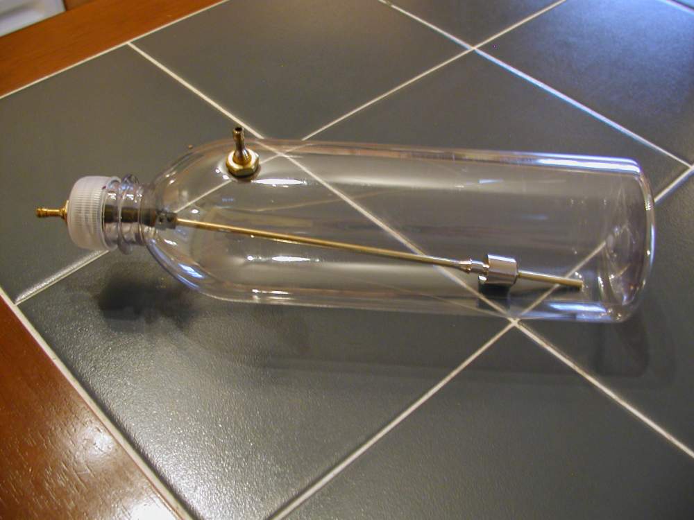

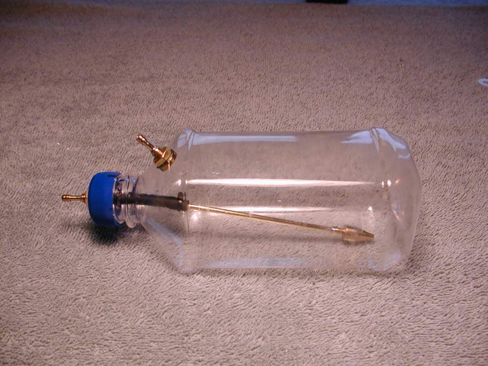

My black rubber stoppers are not going to be happy to hear that.
Its one thing to use wishful thinking
to figure by the time the 15% Gasoline was cut with oil and glow, it'd be more like just 5-8% gas.
But with it starting as 30% gas,
them lil rubber stoppers will voice their resentment in the form of swelling, gunking, & disintegration

San Antonio is a far cry from Fargo in regards to gettin cold.
Its late May in TExas, just how hot does it have to get before I can get the full 85% eth?
You say its no big deal,
but my black rubber parts disagree... they didnt like the amount of gas in the E85 I had last fall,
and the plan is to mix it down to end up with a little gas left in it as we can get away with.
So starting with twice as much is a pain.
Like Kero said,
I plan to mix up some E85 16% castor, which ran the engine last fall,
and blend that with regular glow fuel at 1:1 or maybe 2 (E85/16oil) + 1 (Glow10/18).
The less gas content I start with, the less gas my rubber parts have to put up with

switch over to stopperless tanks

Egad, why didnt I think of that.
I use a film canister tank for my 049,
I cant believe I didnt think to ditch the standard tank and make a bottle myself.
Looks like I need to buy a soda in a bottle smaller than 2ltr for a change
Wonder if the soldering-iron-hole trick works on them like it does on the film canister tank.
