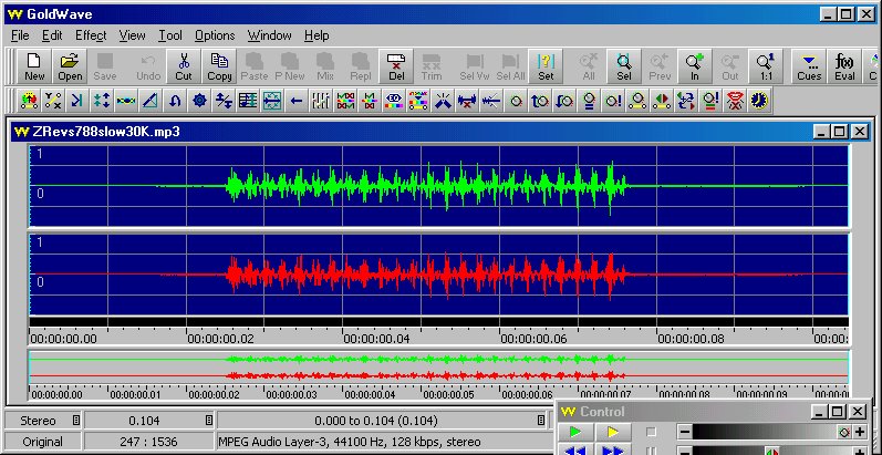

I wish there was a way to stick a prop equivalent to the load of a car's drivetrain to find out what rpm these car engines really hit. I dont know if I trust my Telemetry in my radio and I dont think my prop tach will work on a car engine's flywheel. The crankshaft doesnt have enough of a threaded portion to even stick a 7-8" dia. prop on it.

. Now looking at the screen grab and starting with a pulse that lines up with the .03 second mark and counting the number of pulses to the .07 second mark (where a pulse lines up again) there's 19 pulses in that .04 second duration or 1/25th of a second. So multipying the 19 pulses by 25 gives 475 per second which is 28,500 per minute. On another recording down the main straight his engine was turning 36,000 revs. This was with a Mach 28 engine on 80/20 all castor fuel but with compression raised to 13.4:1 in a Hyper 7.

The only relatively simple way to know how many revs a car engine actually turns on the track is a method I used with my son's car. I took a video of it then played back the video on my computer and recorded the sound. Then I ran the sound through a program (Goldwave) which showed the actual waveform. The screen grab below shows this waveform after slowing it down 100x and now the individual exhaust pulses can be seen. What's kind of neat is that by playing it back 100x slower the pulses sound a bit like flub...flub...flub...
