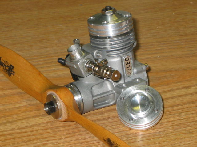

A diesel conversion head is not just screw that is adjusted for length. The screw adjusts the position of the contra-piston below it which in turn varies the compression ratio (thereby changing the ignition timing) of the engine. I make these conversions for several engines (.15 to .46 size). If you would like to try one, let me know and I can send you one FREE to experiment.
Here is a pic of a converted Thunder Tiger GP-42 with a head beside it:
