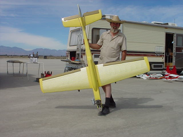

dave, what type of plane is that?

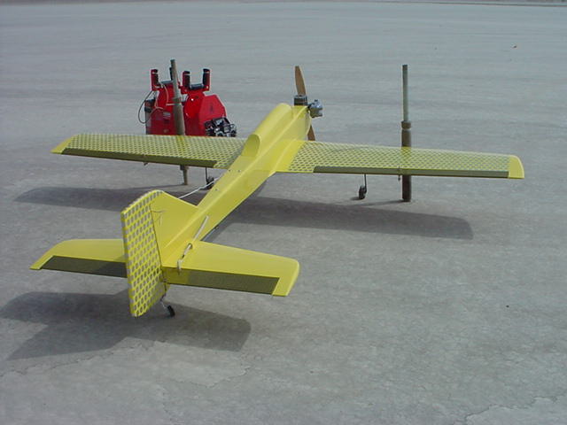

The plane is a Joe Bridi Big Dirty Birdy. It was an early 2 meter pattern plane. They are rare now, possibly obsolete. I have a new header and long pipe for it now.
FBD.
hey Dave, so thats what your ugly mug looks like!!!!
That big yellow dirty birdy looks like my Bridi Escape on steroids. Nice looking plane, but I would have used pink polka dots.
