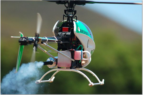

smokin rich, all synthetic, but happy, happy, happy...
