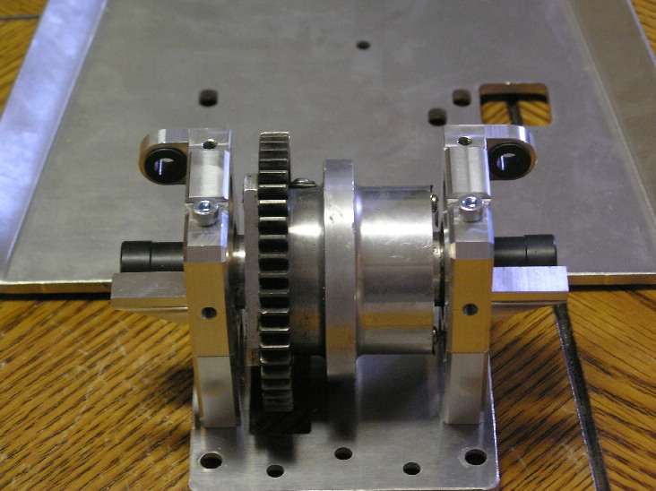

thats an adjustable diff you will need to raise your diff supports 10mm or get Eclon diff supports with built in risers

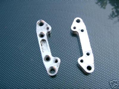

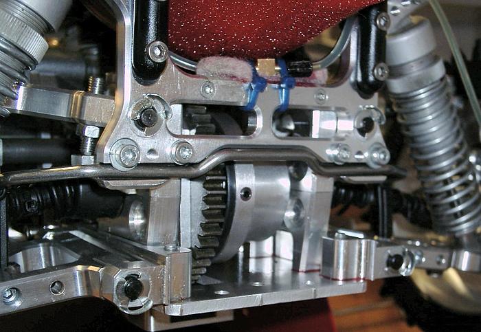

10 mm to let the teeth clear the chassis.. heres my adjustable diif with elcon supports

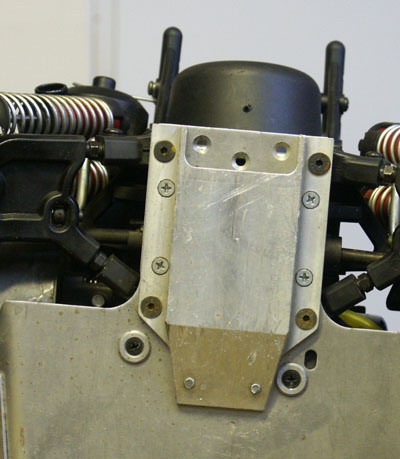

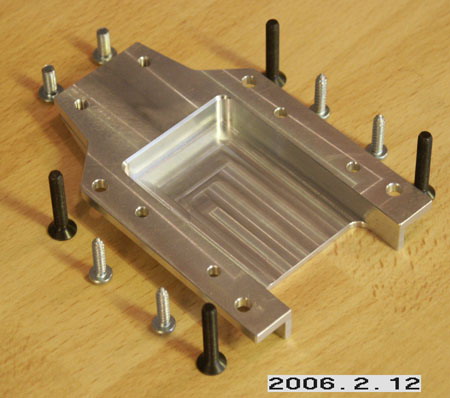

I use this, it protects very well and stiffen up the rear, real good quality and strong, i don't regret putting it on my truck. It's made in Sweden and can be found at http://www.mamut.com/Luthagens_RC_hobby/subdet369.htm
This will also keep the center of gravity low compared to raising the whole thing 10mm, not much difference but it's there.
With this you only have to cut out a little bigger hole, then bolt this sucker on and it takes care of the rockproblem.. letting them pass trough, so no big risk to damage the diffcover with rock get jammed between, and it's not very expensive either. I recommend it [sm=thumbup.gif]

and heres mine,i think the elcon ones raise the diff an extra 6mm,cheaper to make some diff blocks out of a kitchen board like kengentry - or you can normally pick a set of those alloy fg diff risers up for £10 off ebay,as for the diff - instead of buying a full new adjustable one you can get conversion kits to transform the stock diff
