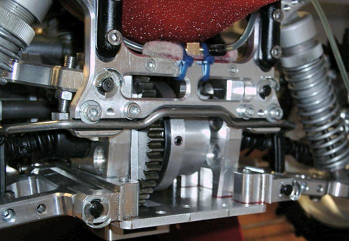

has anyone got fg diff risers fitted and are you using fg alloy mounts or plastic mounts also can you please post some pics as i cant seem to get the alignment right also the brace on the back seems to be too elevated any help is appreciated thanks

Remember when you raise your diff 6-10 mm, you have to put the same spacing inbetween your rear brace and the large motor mount too.............. some people add the spacing to their Motor mounts insted and raise the entire motor

I use three flat washers between the large engine mount and the bottom of the raised brace.
That was recommended here previously by Molzer Mowery and it works well.

yes cheers guys ill use the washer trick for the brace - if i do that it will keep the alignment right aswell

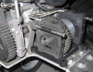

the elcon diff blocks give an extra 6 or 7mm in height,just enough to raise a slip diff without the need for diff risers

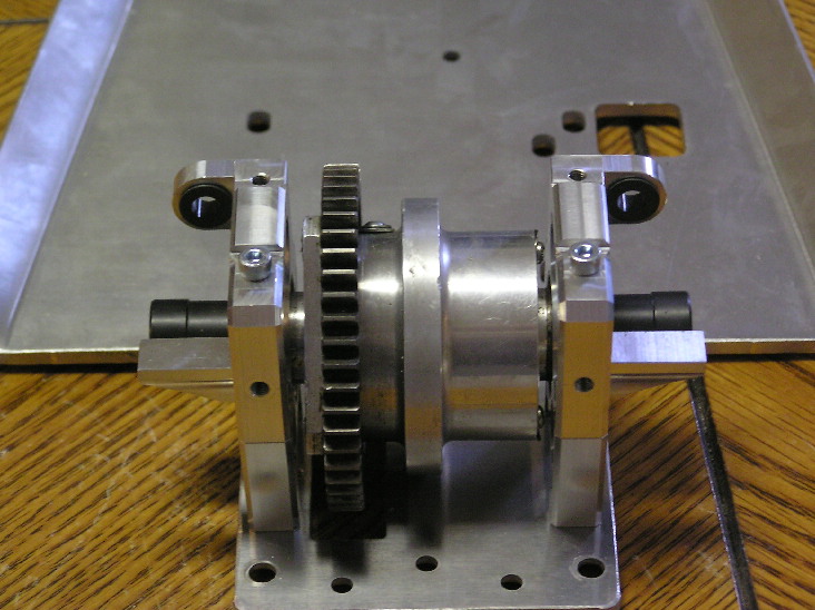

yep I use those diff supports too for my new build[sm=thumbup.gif]
