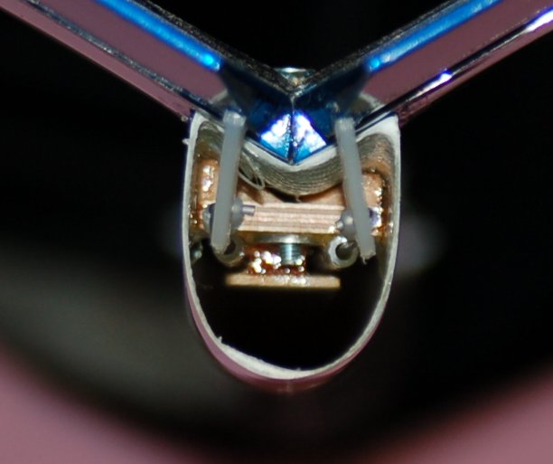

The design for the V-tail is it is held down by that one steel screw. The screw goes through a hole into the fuselage. Inside, they provide one small plywood plate that spans the fuselage to support a T-nut for that screw.
The plate etc will be strong enough. It will, however, take some dexterity to get the plate glued in squarely. It might be worthwhile to glue the t-nut into the plate before trying to glue the plate into the rear of the fuselage. You can use the V-tail and screw to hold the plate in the correct location. Keeping the screw clear of glue is a challenge of course.
By their design, the tail is held down by just that screw. There really shouldn't be any major forces on the tail. It's not very large and is very light. However, the screw doesn't really match up to the tail over much area. I didn't trust something as important as the tail being held on by that single screw. If the tail fit into the trough more accurately, there wouldn't be a problem. But the two go together like oil and water. Let the screw get loose and you're in a world of hurt. Expecting the screw to draw the tail down perfectly aligned was a failed hope for me.
OK, I made a couple of triangular filler blocks and glued them to the top of the plate. Took no more than a couple of minutes. They're made out of trash balsa. Will have no real load on them. They're simply to position the plywood plate square. They will support the plate better in the event of a crash, but that's not their purpose. They make gluing the plate into that tiny tube easy. It could be a nightmare trying to get the screw into the plate without getting epoxy on it, trying to hold the plate in the right place and square etc etc. They also will provide a huge amount more gluing area than the plate too. And they helped keep the screw and t-nut clear of epoxy also. With them already glued to the plate, gluing the M shaped piece in, didn't need any epoxy near the screw or t-nut.

Today was the maiden flight and it went exceptionally well with the settings given in the manual. For anyone considering this plane, I highly recommend it. I want to thank DaRock for all his help. First, the maiden flight: the sun was out and I just got it up about 300 ft and shut the motor off and flew until my neck was tired [20 minutes]. Using a 3S 1800 , it still had 4.0 volts/cell . My "deluxe Hobbyking propulsion system" [see above] had perfect power, it pulls 20A with a 10x8 prop. It has a Turnigy 40A ESC [remeber you need one with BRAKE function], and the battery is way back with maybe an inch out into the canopy area. Weight is 36 oz with battery and a WCL of 3.3.. My other plane is a Phoenix 2000, an excellent value, but with a WCL of 5.3 it would have needed a lot of motor to stay in the game today. Now for the details of construction:
I put RTV under the V tail, plus the one screw; I used DaRock's design for the support of the M3 nut for the V tail; I used the stock 0.030" wire and pre-bent it 90 deg, put wires thru elevon horns and bent again to form a "Z". used 6 pcs Hextronix HXT-900 [these are about $ 3.00]; I hold the canopy on with rubber bands, the birds are the only ones that can see it ! I added a balsa cross bar to hold the motor wires away from the motor; I tried RTV but it came off. I programmed a 7 ch receiver so that I could eliminate 2 "Y" cords but really there is enough space for Y cords and the weight is minimal.
