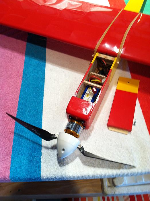

I was really careful when I built the wing but when balancing it before covering it was pretty heavy on one side. Could have been all the epoxy with the brass tubes. I added weight inside the wing before covering. Iwill ahve to go look at the motor and esc packages. The battery is a Hobby king (can't thin of the name) 1300 3s. I think the battery is lighter that the nicads and I had seen that these planes were tail heavy so I have the outrunner out front with battery next then the esc. The two servos are micro not the full size. The servos are pushed together with the arms pointing to the fuse sides, or "out". I didn't weigh it after building so I don't know what that is.
I went to the hobby store nearby where they are into electrics and the owner ordered the motor and esc acording to the weight on the box.
As far as addign weight, I had to add some as far back in the fuse and the rear former would allow. When I balanced front to back before covering I forgot to add some of the folding prop parts. I guess the short story is that Ihave more wieght out front that the kit shows. I think I put 1-1/4 oz in the fuse. When it is all done you can barely get your finger all the way back to the last former. That is why I put so much in. I didn't want to stick it on the outside of the tail although it would have been less added weight over all.
I had to make the nose different because of the out runner. The plan says to use lots of balsa then shape it but motor mount needs for area and I used 1/4 ply which was hard to shape anyway.
Back to weight Ithought of putting the battery back further but the push rods would get in the way and Iwanted the 2.4 rec. isolated.
Hows that?

Here is the poop on the motor. The shop ordered these so the names are not the popular stuff.
Motor is Suppo,1000kv, (label says) BL 2814/8
suppomodel.com
esc is swift CE 35, 15v/4s lipo, linear bec, 6-12 NiMH, 2amp max.

Good to hear from you. I found red electrical rape and works.
I found that the whole wing fits in cab of my crew cab truck so I
leave it taped. The first time I flew it it was nose heavy so I fixed
that. Last time it caught a thermal and I had to power it down it was
going up so fast. Love the out runner. Soars and lands nice but it
is heavy.

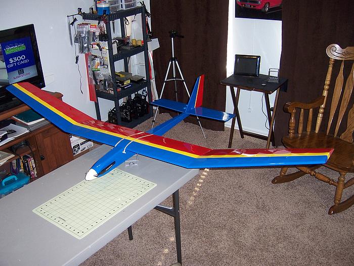

Im just about done with the eclipse now and will give it its first flight next weekend. It came out at 31 oz's with a 1300 3 cell battery and im happy with that. My chrysalis which is a much more modern 2 meter sailplane with the same motor is about 4 oz'smore (and it flys great), had to use a bigger battery to get it to balance.I built a wanderer last year and with the 1300 battery and 450 motor it came out at 28 oz's. I was really surprised thatthe eclipse isbalancing slightly nose down with no extra wieght added.

Icouldnt figure out how to post a picture, but I did manage to put it in the gallery.<a href="http://www.rcuniverse.com/gallery/galleryItem.cfm?itemID=239097&dummy=2836.175507940 1396&opener=/community/profile.cfm%3Fsection%3Dgallery%26memid%3D565422">

I finally got a chance to fly the eclipse today. There was no wind so it was perfect for a first flight. I tossed the plane a couple times to trim it some and it did need a couple clicks here and there. I have a sky limit switch in the plane but had the cutoffs turned off.
With full power the plane wants to pitch up fairley hard so I held in down to keep about a 60 degreee climb. I shut it off after about 20 seconds. That left it at about 400 feet. I had to add a little more trim. The plane just flew great. The elevator felt good and the rudder was very responsive. It flew faster then I expected. I stayed up for about 15 minutes without having to add anymore power. This plane is supposed to be basicly a oly 650 with electric power. I have never flown any of the olympic series planes but now have an idea why they are popular.
The second flight I turned on the cuttoffs on the sky limit switch. It is set to let the motor run for 30 second or 200 meters in alltitude, which ever happens first. It reached 200 meters in less then 30 seconds. I found a thermal fairley quickly (birds showed where it was) and rode that up to 1437 feet. before it was over. That flight lasted 21 minutes.
The plane flys really well, came out lighter then I expected and I really like how responsive the rudder is. When I was building this I had tossed around the idea of adding spoilers but decided not to, I think I blew it by not adding them. I could open the wing back up and do it, but im feeling lazy so I wont, which is why I didnt add them in the first place.
All in all, Im really pleased with how it all came out.
