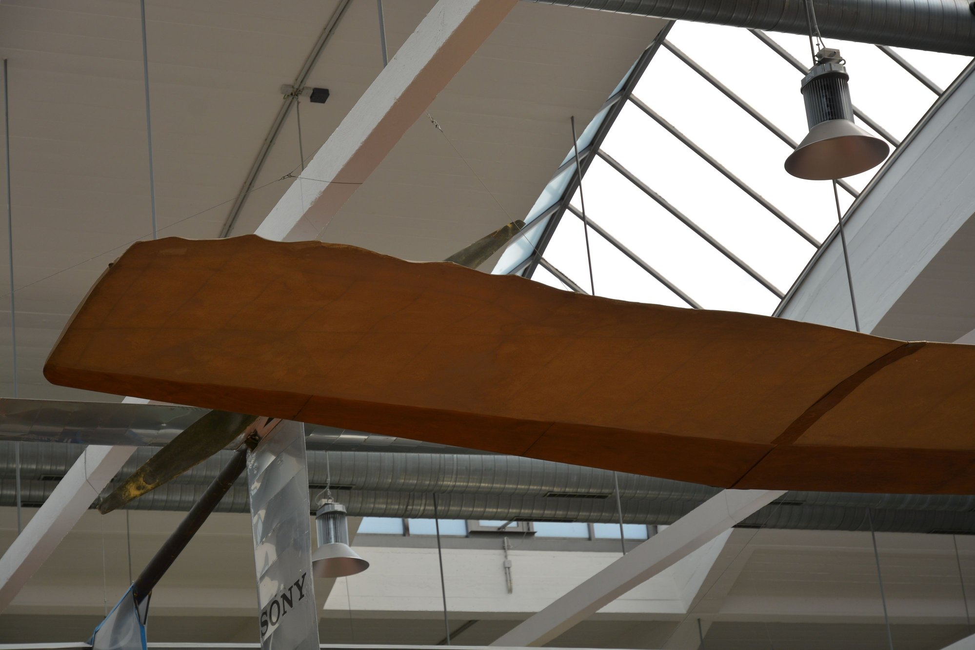

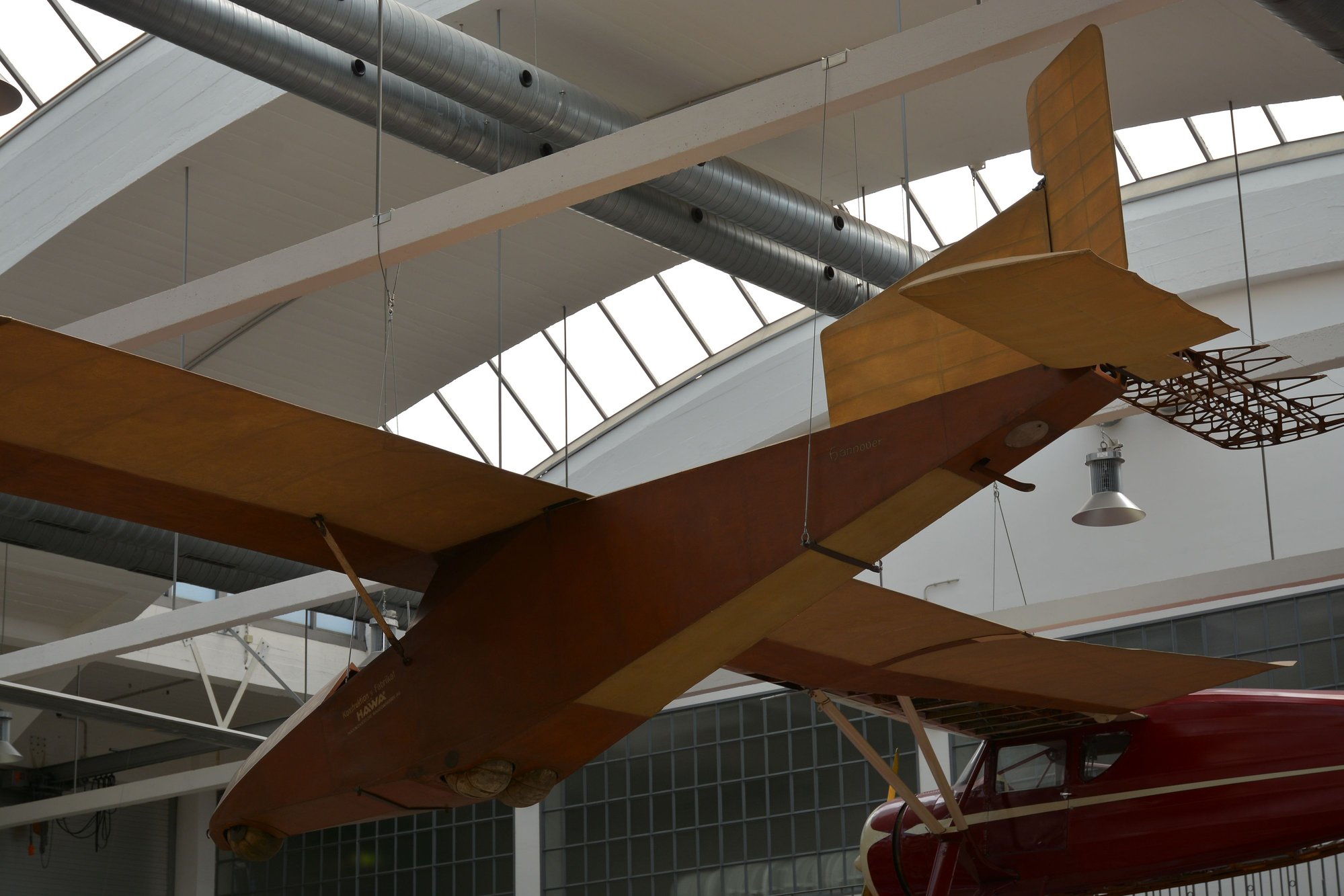

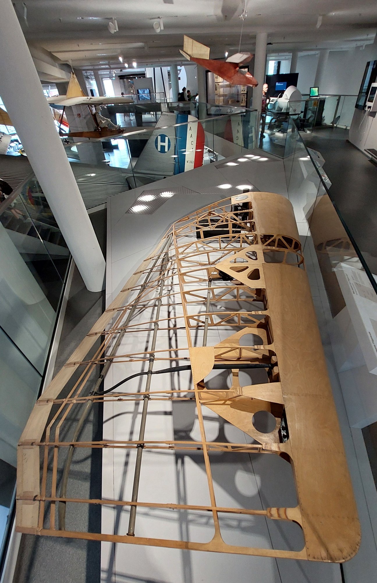

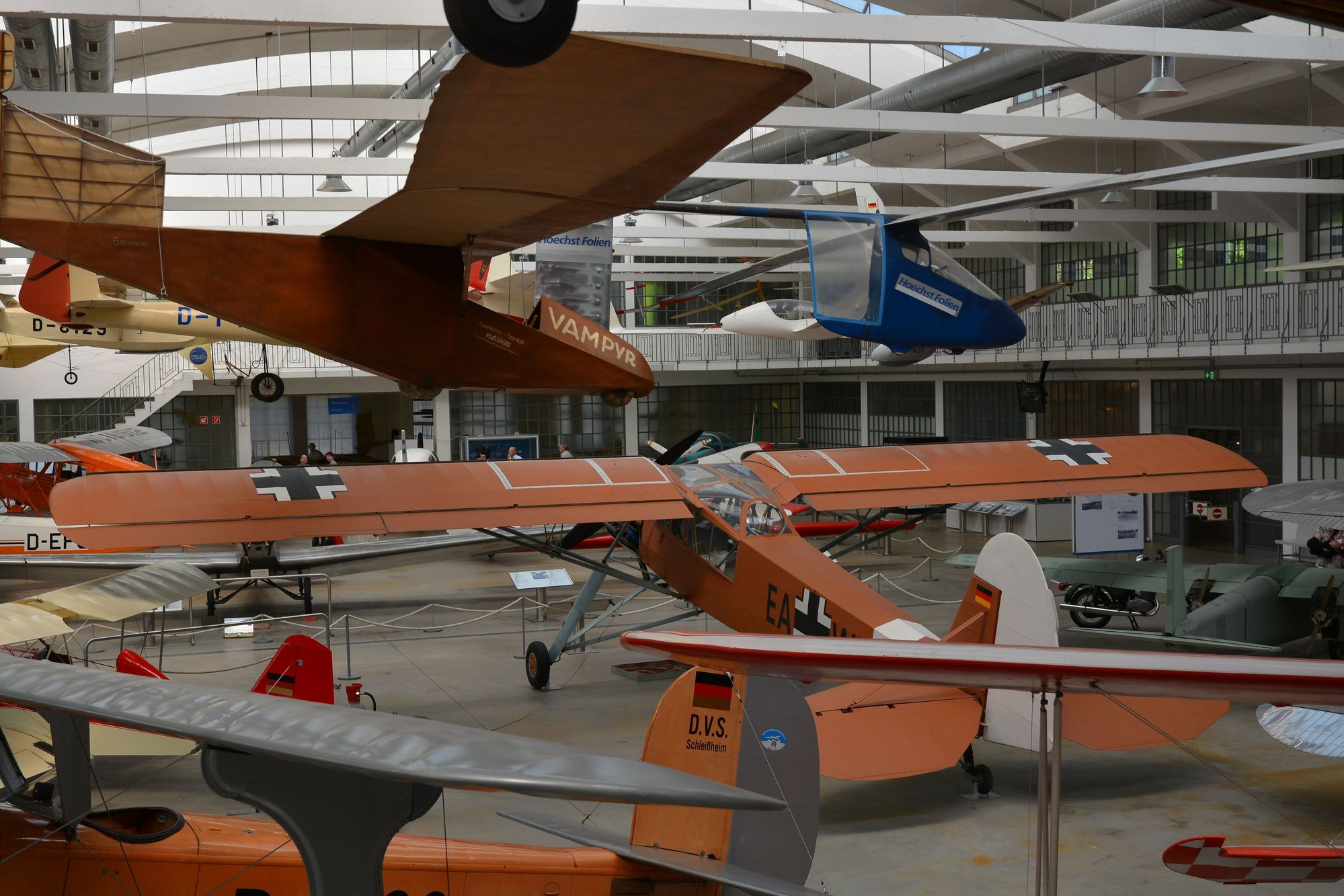

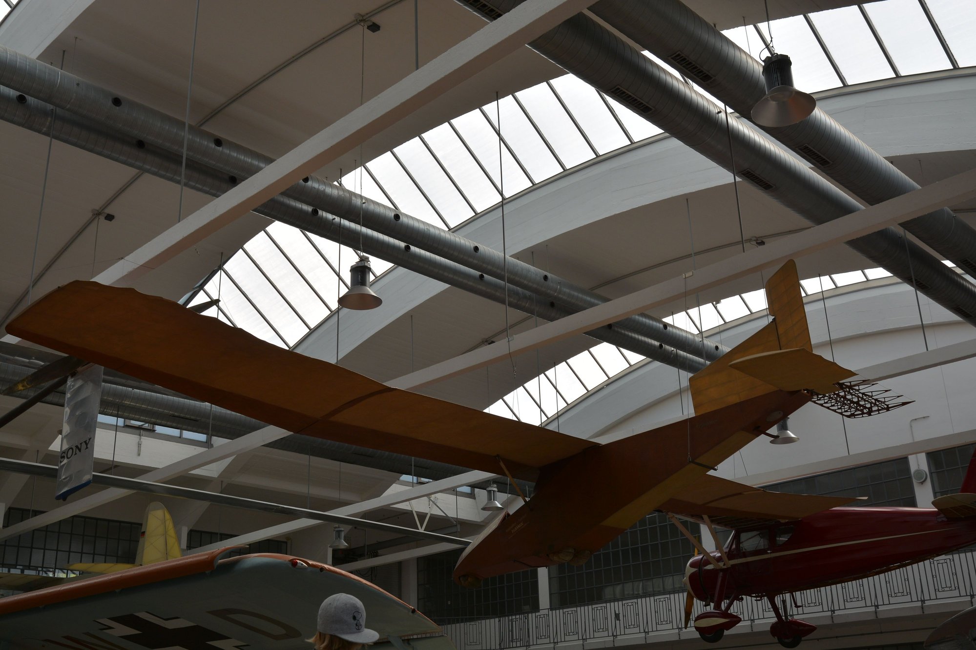

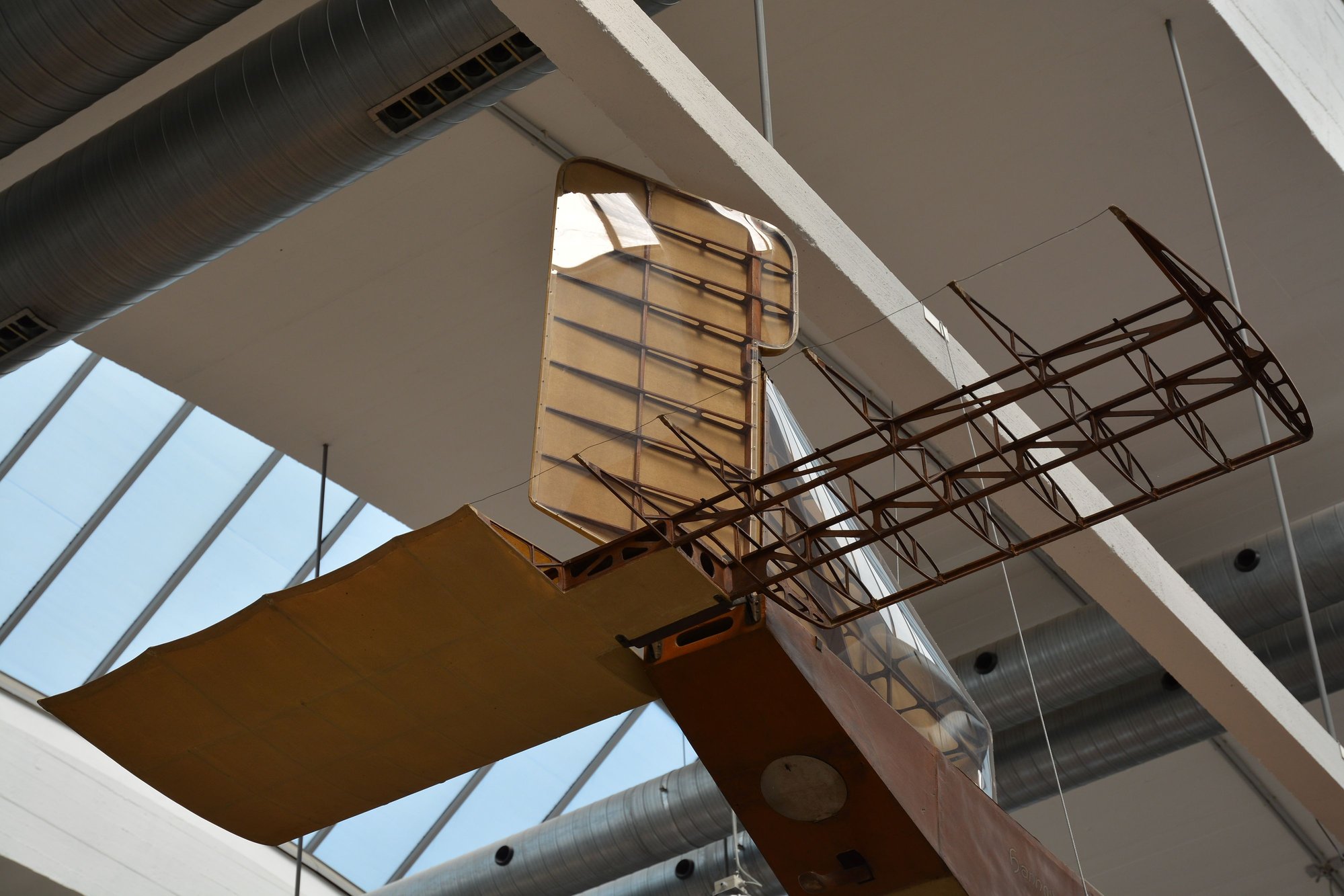

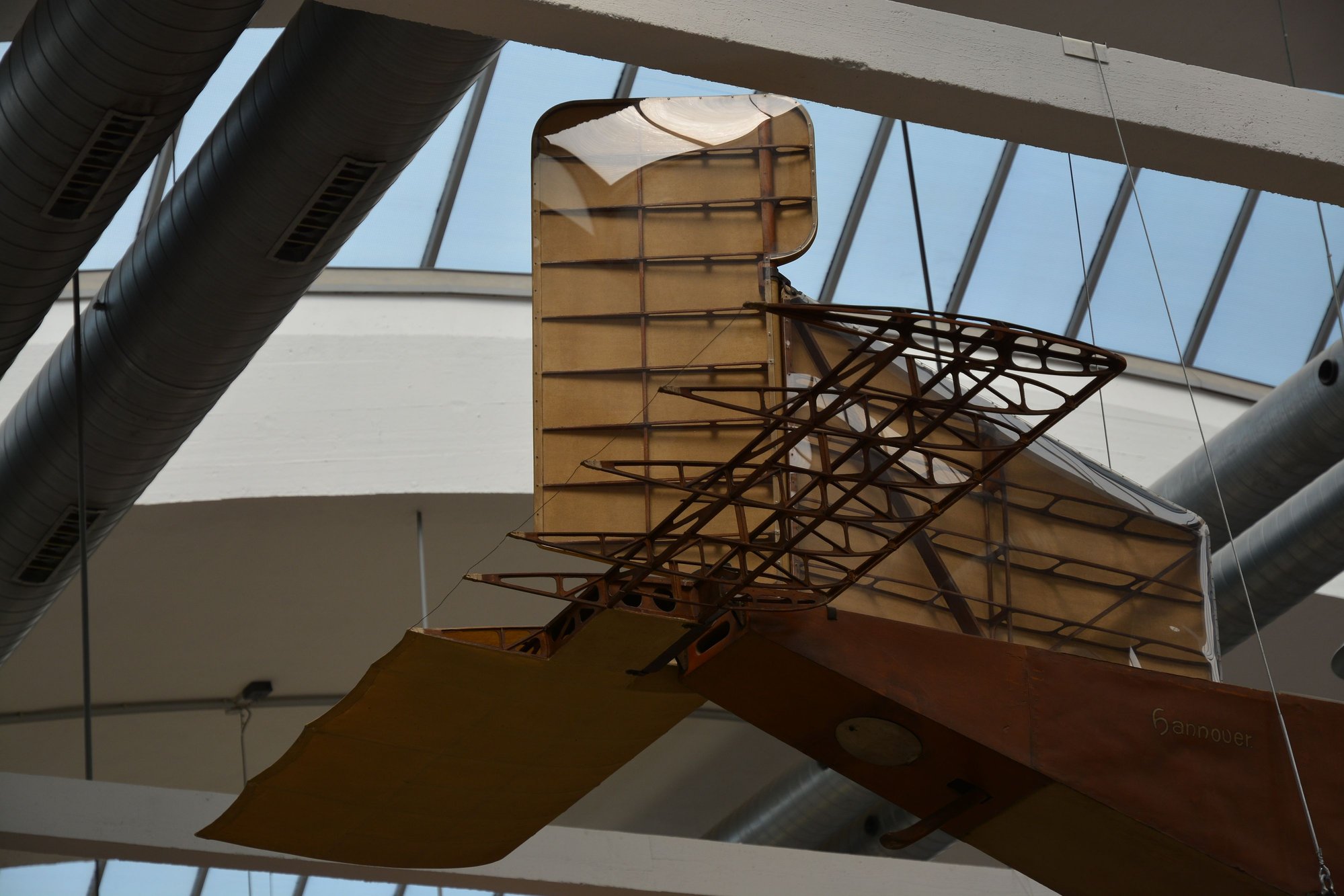

Old 06-04-2025 | 05:38 AM
Joined: Oct 2006
Posts: 1,028
Received 10 Likes on 10 Posts
From: Augsburg, GERMANY
Hi ARUP,
Was in the German Museum today and immediately remembered this build thread. Now that the old pictures are gone I just added new ones from an earlier museum visit, showing a replica build in detail, and two pics from today showing the wing warping mechanism.
