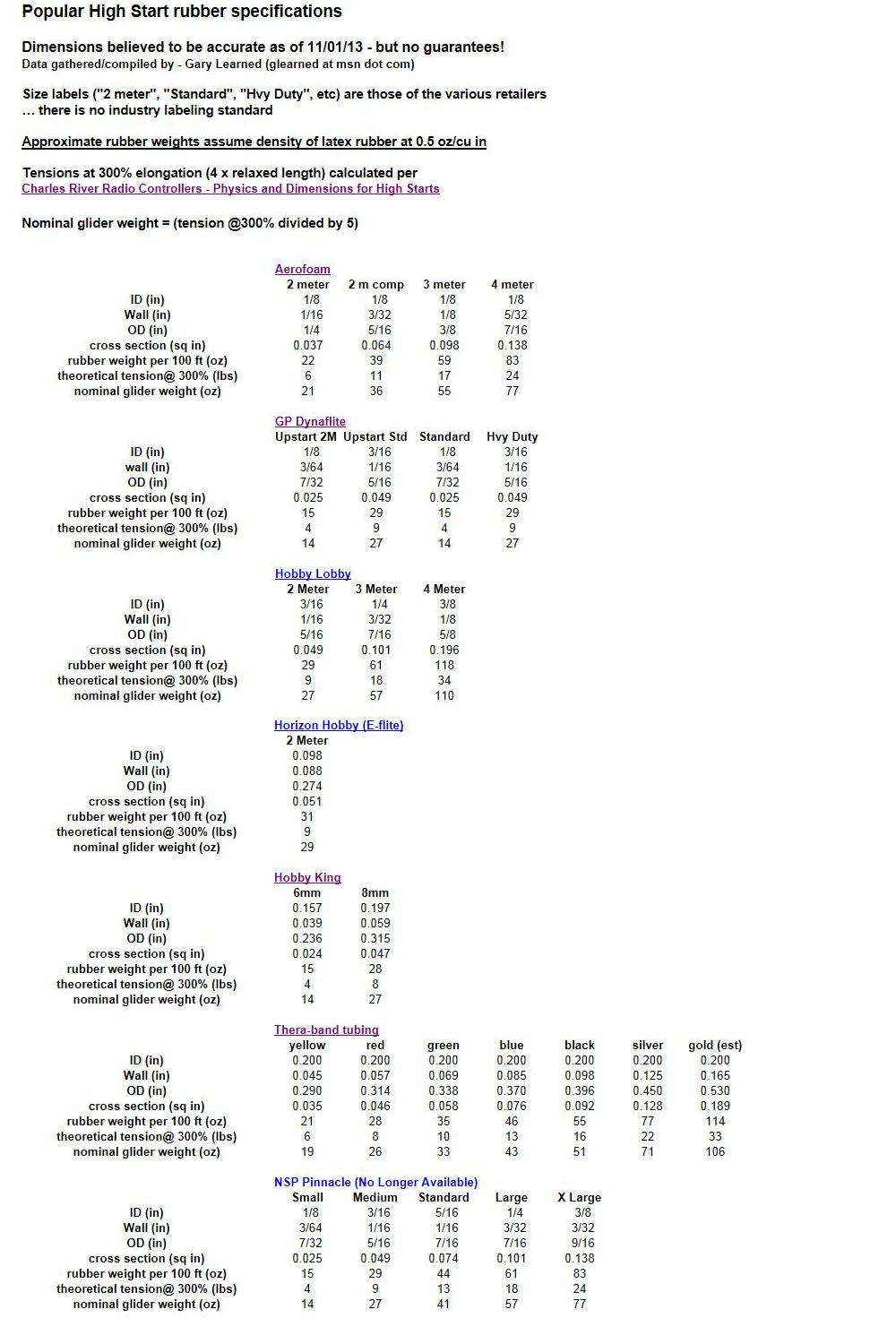

Getting Latex rubber tubing that is sold for hi-starts is your best approach, but there are others. One option is to buy Theraband or similar exercise tubing. Look at the charts to get an idea of the strength.
Try to find it in full rolls as sometimes they sell it in cut up sections for exercise machine use. I have seen listings for 100' but have learned that it is actually four 25 foot sections You can join the sections but it is better to have a solid roll.
As you know the rule is that the hi-start should have at least 3X the pull as compared to the weight of the glider when you pull it 3X its rested length. Remember you don't have to pull it all the way to 3X length to launch. The chart below shows the pull with a 1X and 2X stretch. We are going to go up to 3X so multiply accordingly. Looks like a 1.5 factor from 200 to 300%.
For under 2M gliders or very light 2M gliders in the 1-2 pounds range, the red should work well.
If you are flying 2M to 2.5 meter gliders, in the 1.5 to 3 pounds, the green should be good.
2M to 3M gliders in the 2 to 4.0 pounds the blue should work.
If you gliders are typically over 3 pounds to about 4.5 pounds the Black is for you.
If your glider has a fairly strong wing you can go up a color for a stronger launch. I have launch my 35 ounce Spirit at 12 pounds of pull and I launched 28 ounce Gentle Ladies at 10 pounds of pull, around 6X the weight of the glider but it is not necessary to go that high.
And if you have some heavier glides or want a STRONG pull for a STRONG launch on a strong glider then get the silver or even the gold!
My hi-start would be between black and silver. I have launched 2M through 4M planes from 30 ounces to 85 ounces from that hi-start. On the 2M I may only pull it back 2X. On the 4M or heavier planes planes I pull it all the way.
How much pull can you handle?
That is a personal decision. I can handle the full 24 pound pull on my hi-start by myself but it is a bit tricky pulling, holding and releasing the plane with one hand while holding the radio in the other. For many people anything over about 16 pounds of pull starts to become hard to manage alone. By my standards 16 pounds of pull should be good for a 64 ounce glider in calm air and up to about a 75 ounce glider with a 5 mph breeze.
Amazon has all the colors in 100' lengths but they are actually made up of 4 25 foot sectons that you would need to join. Joining is not hard but a solid piece would be better.

Here's some additional info in the form of a chart showing most of the major players in the high start market (including TheraBand). It's pretty self explanatory, but be sure to read the notes at the top of the page for more insight.

On my machine, you have to click on it a total of 3 times to get actual size... click on the thumbnail to open, then click on the super thumb to get web page format, then click once in the imaged text area to enlarge.
Yes... I'm too cheap to buy the Adobe converter. :-) I've heard there are some free converters out there, just haven't gone looking... any suggestions?
#73
That worked. Thanks.
I have seen these theoretical tables before. No problem with them as I have not tested everything he has listed. However I have tested and used the Aerofoam 3M, the Pinnacle L and the Dynaflite HD. On those three his theoretical numbers come up 2-3 pounds below the actual measured pull that I got during tests at the field using a spring scale. For example the chart predicts 17 punds for the Aerofoam 3M. We have 3 at the field and they all test at 19 pounds using two different scales. That 2 pounds is about an 11% variation from the predicted. Not bad and it is probably better to err on the low side and that is how I see these tables, about 10 to 15% low.
Maximum glider size is another point of departure. He uses a 5:1 ratio of pull to glider weight but he does not qualify the basis of that ratio in the table. I have found that 3:1 is adequate with a 5 mph breeze for most gliders. I have found that 4:1 is good in calm air and very good with a breeze. 5:1 or higher is what I call a strong launch which is fine but not required. I have launched as high as 7:1.
However, again, these are opinions so mine is no better than his. There is no objective standard so there is no right or wrong. I will tell you that an 82 ounce Legend has been launched with an Aerofoam 3M into a 5 mph breeze with no problem.
But all information is useful. The reader has to judge and these tables at least give relative numbers to look at. The absolute numbers may not be exactly right but they are close enough and the strength ratio of one to the other is probably pretty accurate.
Precisely... that's why I put the chart together. Otherwise it's difficult for a novice to understand, for instance, why the Dynaflite Heavy Duty, Hobby Lobby 2 meter, Hobby King 8 mm, TheraBand Red, and the NSP Medium are all the same device, practically speaking.
