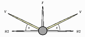

V-TAIL DESIGN - AREAS & ANGLES
The design of a V-tail equivalent of an orthodox stabilise r and fin.
It is assumed that the vertical (fin) and horizontal (stab.) areas for the conventional empennage are already known, perhaps from previous experience, or from using some design criteria. The requirement is to determine, for the V-tail configur ation:
1.the equivalent V-tail area,
2.the angle between the V-tail and the horizontal.
The diagram represents a view looking along the centre line of the aircraft, the length of each line is proportional to a surface area.
F = the desired fin area,
S = the desired stab. area,
V is the area of each of the V-tails,
x = the angle between the V-tail and the horizontal.
The basic equations for each side are:
1.Vcos^2(x) = S/2
2.Vsin^2(x) = F/2, therefore,
3.(x) = arctan . square root(F/S), for both sides together (from 1 & 2):
i.(F + S) = 2V(cos^2(x) + sin^2(x))
ii.since cos^2(x) + sin^2(x) = 1, then 2V = F + S, ie., the total wetted areas are equal
Example:
Suppose that F = 50 and S = 100 sq. ins.
thus, c alculating the area:
V = 150 / 2 = 75 sq. ins, (ie., the area of each half of the V-tail).
and, calculating the angle:
F/S = 0.5,
tan(x) = square root(0.5), = 0.707,
x = 35.26deg (or, in terms of the included angle of the "V", (180 - 2 x 35.26) = 109.5deg),
Good luck..
Regards,
Ron

I did a similar conversion of an Airtronics Olympic 650. I was sloping it a lot and wanted more durability. The entire fuselage was glassed with epoxy. [X(] The result was a winged baseball bat!
Calculation showed the stock horizontal tail to be oversize. The horizontal surface was almost all fixed stabilizer and very little elevator. At first I simply removed the vertical fin and rudder, cut the stabilizer and elevator in half, and reattached the stab at an included angle of about 110 degrees. This removed the weight of the vertical surfaces without adding anything, so the nose got quite a bit lighter. The result was a glider that was very stable but not very responsive.
New surfaces were built using the same external shape but with the hinge line moved forward. Now the elevators were more like 35 percent of the total area. This resulted in an easy-to-fly, stable, and responsive glider that would self-thermal with a bit of elevator held. It was a real pleasure to fly and fuselage breakage was impossible!
