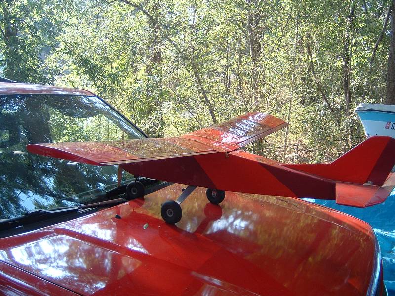

Ecead: good luck try'in to get sig to send you a part or a plan as I've E-mailed, sent letters an even tryed to call em bout a part for my sig senior, I don't think they care about foke who just want parts. I own four sigs but don't think I'll be get'in any parts or replys from sig' but weve got some inovative guys on this forum to help us out, I've built a mess of Sigs though the years, it's to bad they don't care about the fokes who spend hundreds of hours build'in there planes an might have a ?'s or a request,
