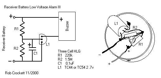

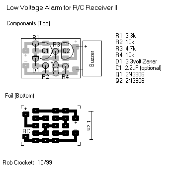

Low Voltage Watch - Mostly of value with gliders or glow planes
In addition to helping me find the plane, both locators also monitor my
battery pack voltage and sound an alarm if the pack voltage gets below a
safe level. This is especially valuable on my gliders. If I catch a good
thermal, or if I am slope soaring, I could be in the air for over an hour, so a
pack that tested good on the ground could run low during the flight. These
alarms would warn me during the flight. If the plane is not too far away, I
can hear them in the air.

Make your own!
Here are a couple of examples I have made and used that work well (I did not design them).
The first is for 3 cell (NIMH) HLG - uses only 4 parts but they are more expensive. Can be used for 4 cells and lipos too but you will need to change the value of the resistors and I do not have that data (someone here will probably work it out).
The second has a higher component count and may need a circuit board or vero board, but can also be direct wired together and encapulized in epoxy. It has a 4.4volt cutoff.
Both sound a piezo buzzer (take off an old computer motherboard) when they reach their cutoff voltage. BUT via the capacitor, they also can sound off with vigorous movement of servos as they temporally load the battery on startup. The caps as shown allow intermittent sounding as the battery nears drained. A higher value cap will limit this tendancy. So if the model is lost you can wander about waggling your controls for some hours and getting intermittent beeps.
They are very light and only use a couple of milliamps in monitoring mode. I guess you could also adapt them with another resistor to flash a powerful LED. All parts available from RS Components. The National TC44 is the most expensive part but is used in most portable devices like cell phones to monitor batteries.

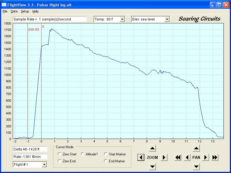

Lost my 2 meter Poly Pulsar yesterday
dumb dumb dumb
I had been flying it with a Sky King Lost Model Locator, but recently took it out to connect up a RAM3 altitude logging device. AR6250 Rx was running out of pins. Been having some great, high flights (1700 feet) and wanted to have a log of flight duration, sink rates, etc.
Well yesterday, I stayed with a big CU, sharing a thermal with a hawk, drifting downwind for too long. When I went to come back to my field, wind aloft had increased, and I wasn't making headway, at altitude, so dived a bit towards my location with flap (first mistake?) . Now tried to stay lower, with power, but couldn't see orienation of wings; kept looping, or steep turns losing altitude.
Finally lost it below first tree line, cut power and selected full flaps hoping to find it in a field. Had the RAM3 on board too.
Well, after two days of walking a line, with GPS from launch site to tree ridge it went behind, no luck. Lots of thick, thick forest, Pulsar could be very high in canopy too.
Now we are getting stong rain and wind, end of the Pulsar, even if I can find it. Was going to try a tree top recon mission with my Ascent rigged up with video cam today, but wind never let up.
So there has to be an answer to losing these sailplanes. Maybe next time I launch an expensive sailplane, I will have the Walston system on board. Would have saved me a lot of grief. I hope none of you ever have to look for a nice sailplane like this.

LML might have helped, but there is a lot of woods here where it went down. LML does work with AR6250 if you follow instructions on SkyKing web site. I'll be flying with a LML in everything now! graph is from Pulsar a few days ago
