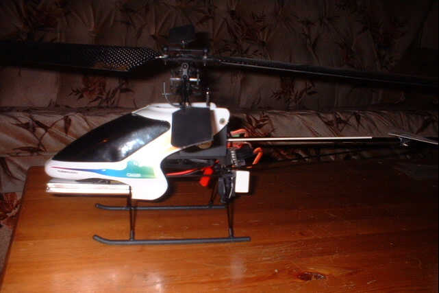

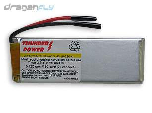

Just get yourself a 7.4 volt, 2100mah lithium battery, that will give you about 15 to 20 minutes of flying (depending on how hard you fly). That's more then long enough for those little motors (they get to hot). I have one on my HummingBird, works great.

Actually what i was thinking was to be able to fly with two 11.1v lipos. that would give about 40 mins or so depending on a few factors.

Yeah I do have heat sinks on my motors, but they still get hot. The problem with 11.1 volts is they are a lot heavier, and the last thing you want to do is add weight to your micro heli, you want to try and take weight off if you can (get them as light as possible).
