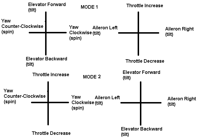

Ok sorry guys but im new to the heli stuff but here i go.
What are the basic controles for a heli on a basic tx.
I have got my tx setup for FSM.
I just need to know on the left thumb stick what up and down is and left and right
and the same with the right thumb stick.
The TX i have is only 4 channels but i also have an 8 channel but
i am useing the 4 channel for now.
Anyinfo Would be wonderful

The left stick controls three things. Up and down on the left stick is the throttle and also the "collective pitch", the angle of both the blades as they bite the wind. Down is throttle off and flat pitch (no bite.) Up is max throttle and full bite, so you go up. Left and right motion of the left stick is your rudder. Move the stick to the right, the nose of the helicopter will go right. Left stick, nose left.
The right stick controls two things, called the "cyclic pitch", it is almost like the joystick of an airplane. Right motion will bank (tilt) the helicopter to the right, left left, back stick will raise the nose, forward stick will make the ground get closer in a hurry.
The helicopter wants to do things on its own too. The tail rotor is blowing to the right, so it pushes you to the left, so to stay in one place during hover you need to fly slightly right-skid low with the right stick a tiny bit to the right of center. The torque from the main motor/rotor wants to spin your nose to the left, so you need to vary the amount of left stick rudder motion to keep the nose straight as you climb and descend. Many helicopters have gyros to help with this part.
It's kind of complicated but you'll figure it out.
You really need at least 5 channels to fly any helicopter except for the most basic types. Most people use 6 channels so they can adjust their gyro in the air. If you have scale stuff like retracts you need even more channels.

Oooh! I have made a pic just for this!

And in Kansas (and in most of the rest of the Western hemisphere) you will want to be using Mode 2.
Great drawing kelvinator9!

Yup the lama would be a good starter, so would the eflite cx2.
The Mode 2 thing, I think, is because on a full size helicopter the controls are sort of the same--left stick or handle is collective, throttle can be a twist grip on this stick like a motorcycle throttle, right (center, between your legs) stick is cyclic, feet work the rudder (anti-torque). And the cyclic works like the joystick of a full-size airplane controlling pitch and bank too.
Mode 1 is used in Japan, UK i believe, Australia, elsewhere. I'm not sure why, I think it might be a historic relic--from the days of 2-channel airplanes with single-stick transmitters: throttle up and down, turn left and right.
Most of the good simulators give you the option of using mode 1 or mode 2. In the US or Canada they will default to mode 2, and you may need to special-order a mode 1 version. I'm not sure if you can switch your transmitter, I know mine can't.
And finally (no offense kevinator9!) mode 2 is better.
