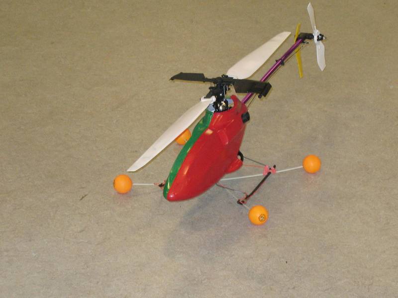

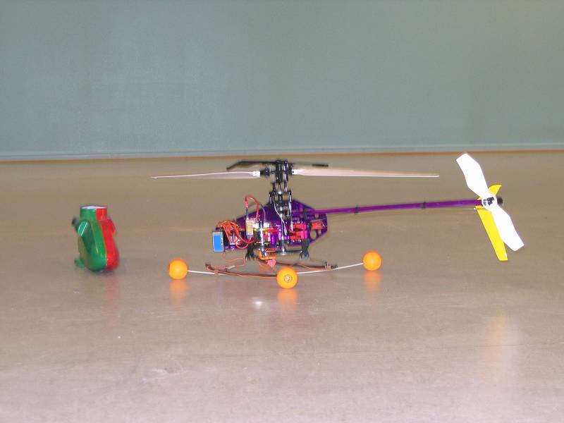

Bing117 (a Danish heli newbie still trying to hit his first decent hover - pictures of my second heli attached)

Hey Bing, what kind of heli is that? Looks pretty cool, with that canopy it must be pretty easy to see at a distance (always a big problem for me!)

The point of the paint scheme is exactly to make it a bit more easy to see what direction the ship is heading: The right half is green while the left half is red. This is inspired by the lighting on ships where green = starboard = right and left the other side. On a Corona 120 this is very easy as the canopy is delivered in two halfes anyway so I just painted those two before assembling them.
