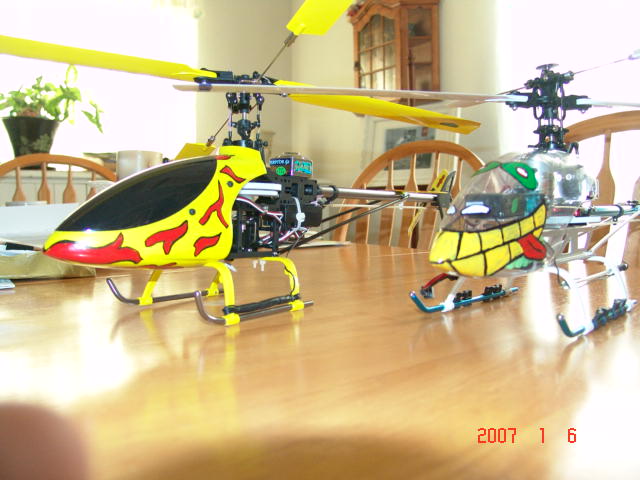

sorry about the the heli its not easy trust me i have two helis and have been doing every day for a month and still have some trouble hovering...my parts have cost more then the helis them selfs so dont feel bad...the sims help some times but i have trouble doing both...its diffrent on a sim then the real thing...when i hover its almost scary the actions i do when i panic and it hits the ground and see parts go every where..i just destroyed my raptor g2 and and now i am down to my walkera60...but hang in there because you arent the only one here that has trouble....good luck and god bless
