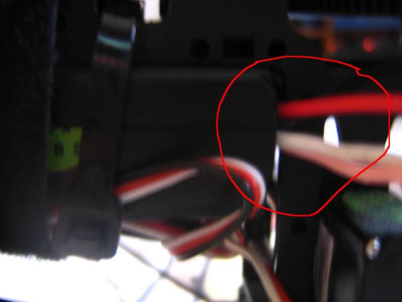

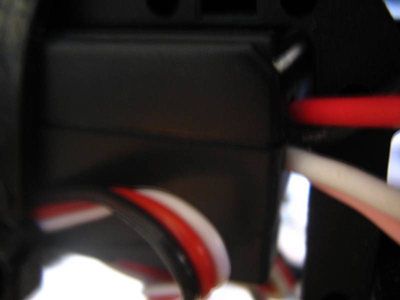

Guys, i'm going to buy a TX, next year[&o], but i want to ask something that i can't get it. I have a walkera 36 which has a receiver with 4 channels and 2 linkages that come out of one hole of the receiver. These linkages are the power supply and the motor supply. The receivers i see know, have NOT such linkages come out of the receiver. They are channels like the other.

You are describing the difference between an stand alone receiver and an all-in-one receiver/speed control/gyro/mixer.
A stand alone receiver has an antenna and a series of pint to plug servos into. Power for a stand alone receiver comes from either the speed controller or a separate receiver battery plugged in to one of the servo slots.
An all-in-one unit provides the functions of a stand alone receiver, as well as an incorporated speed control(s), a gyro and the revo mixer.
