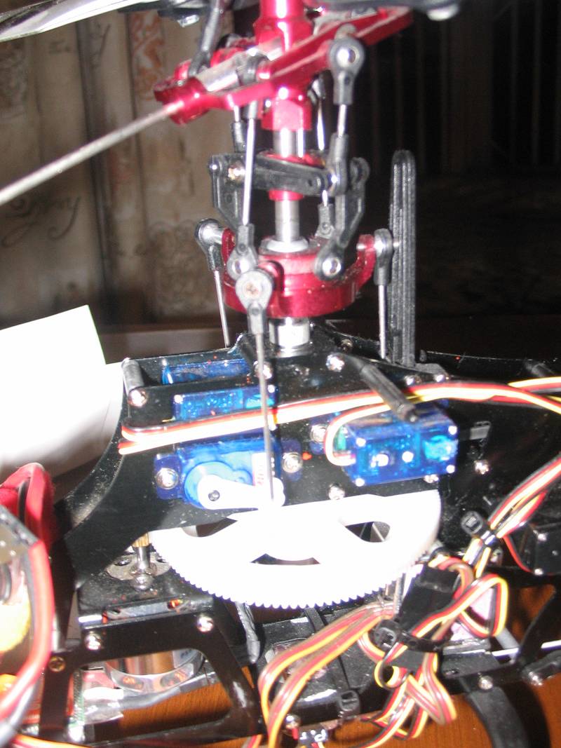

I should have mentioned that I bought a used Heli and it is completley upgraded . I have included a picture of the swash plate. It doesn't look like the one for 1-S above . Does anyone recognise it?
Cheers
Ed

ed_c6:: ... I should have mentioned ... It doesn't look like the one for 1-S above ...
Yep ... should have ... woulda saved some bandwith ... and possibly a crash and maybe a headache during setup ... but other than that ...
The picture I posted is from the MX400 Pro manual ... so it's what the original config was.
This (ooooh .... shiny ...) is:
a swash of the 120° persuasion ... a CCPM swash config ... which is a different animal indeed.
Looks like the right side of the heli with elevator servo near right and pitch servo near left and aileron servo
far side.
In that case, DON'T USE 1-S and use 3-S instead ... and start brushing up on the SWASH AFR menu
and what it does.
From the 6EX manual: 3-S: With Aileron inputs, the aileron and pitch servos tilt the swashplate left and
right; with Elevator inputs, the three servos tilt the swashplate fore and aft; with Pitch
inputs, all three servos raise the swashplate up and down.
