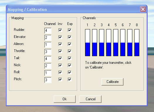

I ran the programand and when it came to calibrate the controller, it only moved channels 5,6,7,+8. I'm sure the channels should be 1,2,3,+4. I need to know what channel assighnment and which box's to check on the calibration page! I would welcome any help, Thanks!

mine is set like this

i had mine set like cincy's but i only had the inv boxes checked..worked great! jake.

Jaketrouble and Cincy, I had another joystick plugged into my comp ,without that, it works Perfectll !! Thank you! You guy's really help us beginnners!
