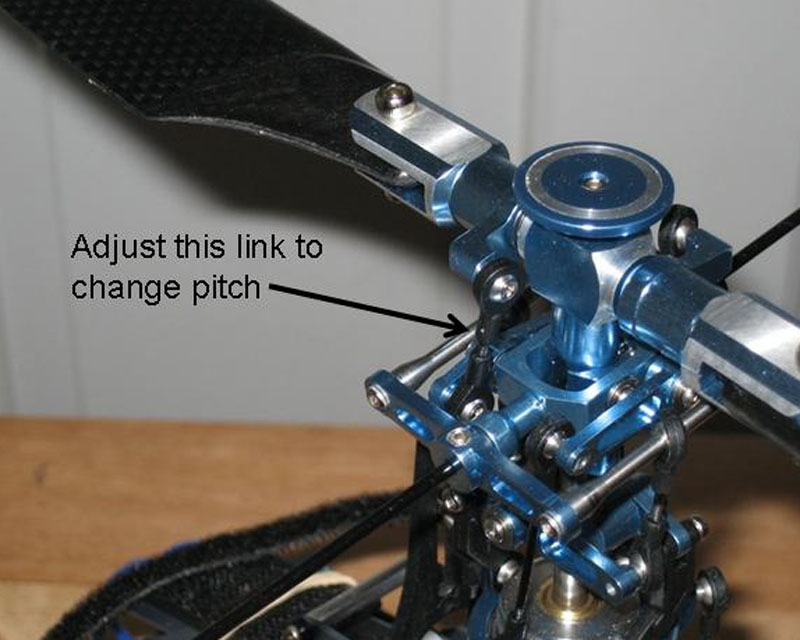

I have a madhawk 300 airwolf, how do you adjust blade tracking, it says to turn the control link, but can't find anywhere where it tells where the control link is
thanks for any suggestions

I'm not familiar with the MadHawk but it looks like a nice helicopter. If it has an ajdustable pitch like this then you will adjust the links to change the pitch for each individual blade. On my BlueRay 450 in the picture, adjusting the link in (making the link shorter) will increase the angle of attack of the blade relative to the other blade therefore raising the track of the blade. If you increase the length of the linkage then you decrease the pitch relative to the other blade, lowering the track of the blade. The arrow is intended to point to the black link the goes up to the blade. I hope this is helpful for you.
