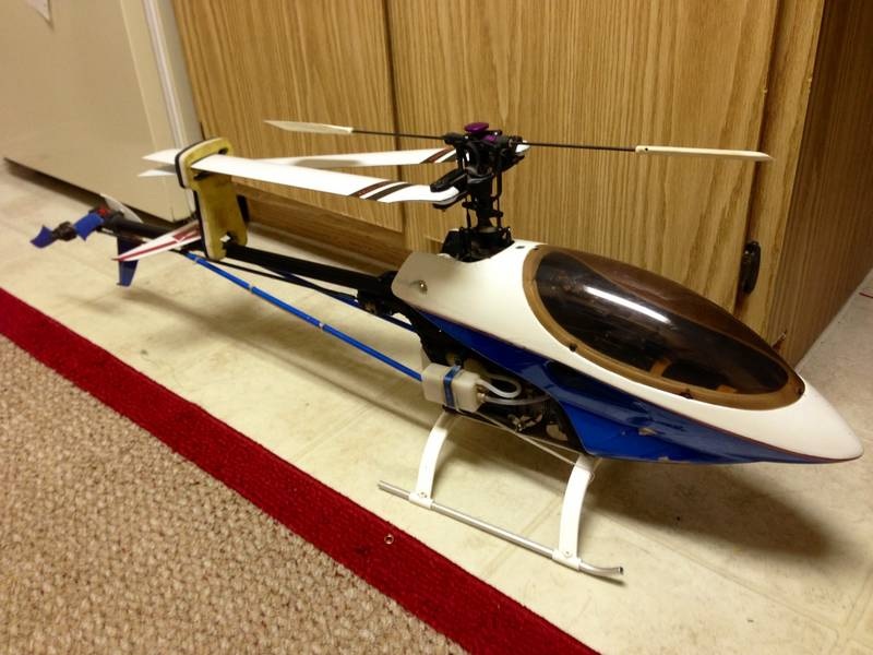

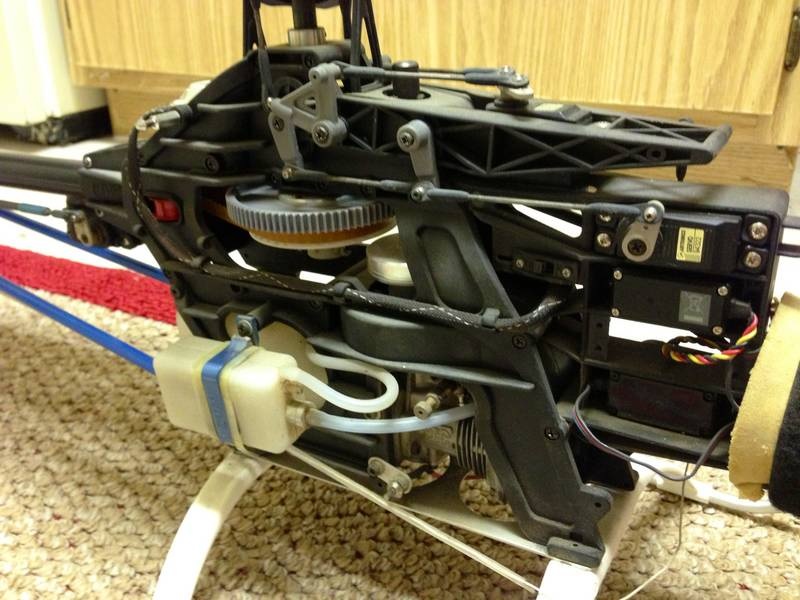

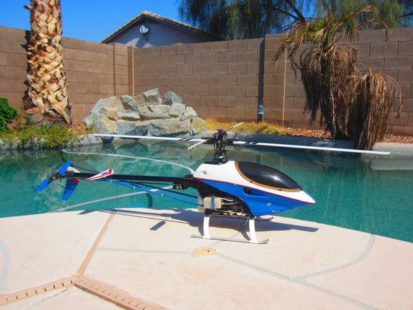

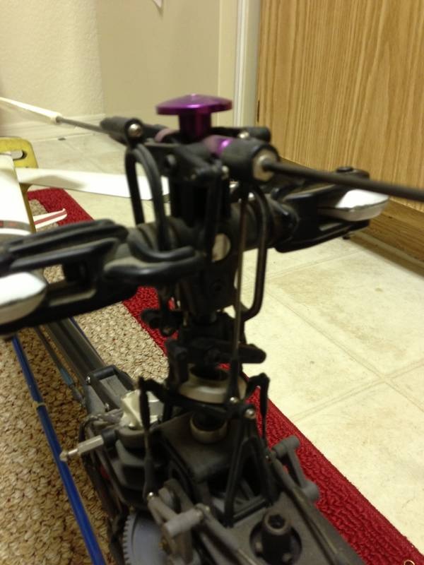

My Feedback: (11)
It looks like a V2 to me.
If the head has hex bolts that thread into the spindle shaft then its a V2 for sure.
If the head has a threaded spindle shaft with nyloc nuts, then its a V1 head.
Sure looks like a V2 from the pictures though. I have a decent familiarity with Raptors.
