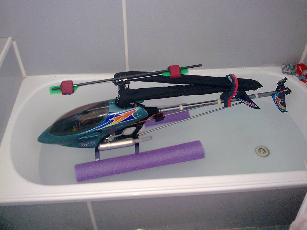

Old 08-17-2009 | 10:54 PM
Aus_Panther's Avatar
Joined: Jun 2004
Posts: 24
From: GladstoneQueensland, AUSTRALIA
Default RE: heli floats
My Titan with Pool Noodle floats on a test float in the bath after making them. Going to put some carbon rod (off my training gear) through the middle of them so thy don't bend behind the skids then all will be good. And only cost $3.00 Now just gotta get the guts to fly off water with them.............

Old 08-18-2009 | 04:33 PM
BarracudaHockey's Avatar
My Feedback: (11)
Joined: Jul 2003
Posts: 28,287
Received 444 Likes on 363 Posts
From: Jacksonville, FL
Don't dilly dally when you power it up, get the head up to speed or that shaking you see during spool up will be amplified many times.
