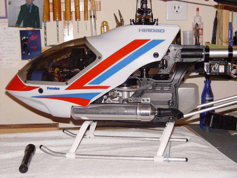

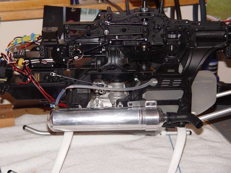

Any of the Hatori "cans" for 60-size engines.
I've got an SB-9 on my EVO/.46 FX-H; it sounds like a 30.
A 90-size would be even better; but your machine would look like it was equipped for anti-submarine warfare...

Here's a peek...

With the canopy on...
