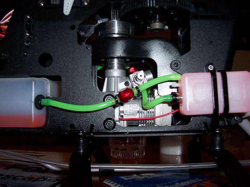

I know that there is someting wrong with my setup besides the fact that I dont have a fuel fliter.I have removed them to start troubleshooting Engine running very poorly. This is a Venture 30. Any tips would be appreciated..

your running lean right? now matter how much you richen it still act's lean? I see 2 probable causes... by locating the header tank where you did you effectively moved the tank away from the engine... sounds strange since your header tank is no farther away than the main tank right... nope the engine does not see it that way... it's still looking at the main tank as it's fuel supply, only now it's MUCH farther away because it has to travel through more hose and a tank before it gets to the carb. In the pic's it looks like you could mount your header between the main tank and carb... that would be the best spot. the other thing is the header tank center line is lower than the main ...the main is already low, you want your main tank centerline about 1/8 inch or so below the carb centerline... moving the main tank is not worth it... it's not that much lower HOWEVER your header is lower than the main... not good, you want the header centerline to be up closer to the carb centerline... about 1/8 inch lower if possible.

When the engine does run, it runs horribly lean. Lean to the point that I have to hold on to the head or it will just tear its self apart. IT WILL NOT idle at all. I did a factory reset on this engine (OS 32) which is 1.5 turns out. Its not running at all like its supposed to. I just put the header tank on tonight. Up untill then I have had no complaints about this engine at all. If you look up and to the left of where the header thank is mounter now you will see a hole that I drilled and first tired the tank way up there. Also didnt work, same results. Also should I lign up the top tube coming off of the header with needle valve or at the top of the carb intake??? Is there anything wrong with the length of fuel line that I used???

it's hard to tell by the pic... the hole your talking about is about 1 1/2 inches above and say 1/2 inch to the left of the header's current location? if so then your still not located right. see if you can get that header between the engine and main tank... set the header tanks center(middle of the tank) about 1/8 inch below the carb centrline... use the high speed needle as your carb centerline.
John
fuel lines... keep the line between the main and header as short as possible... keep the header to carb line also as short as possible BUT go ahead and add your filter/ fueling set up and keep it long enough to make fueling easy.

I mounted the tank right in line with my other tank, which ends up to line the top of the tank up with the midle of the needle valve. have checks the lines and ran new ones. screw in bottom of muffler is expoy in.
Engine will not start unless primed by holding findger over muffler. once started, it only runs for the amount of time that the priming puts fuel in the cylinder, which is about 3 seconds. This whole time it is running very lean. then it dies. It obviously isnt getting fuel (compression).
dont know why at all..
Who would have thought that a lously header tank would have taken so long to work out the problems. Easy 5 minute job....
Also, I have changed the picture at the top to a current one of my setup..I see no reason for this not to run perfectly.

Since installing the header, have you tried going back to the main tank? If the engine runs fine on the main tank (as before) then the problem is in the header tank set up. If you find that the engine runs crappy on the main tank, you need to look at the throttle needle settings again, particularly the low speed needle. Try richening the low speed needle.
This may sound like a stupid question but is the header tank filling up when you run the engine? Have you checked to make sure that the filter you're using isn't plugged?
Also, the header is at the same level as the main tank which, it appears to me, would not gain you any benefit. As suggested, I'd set the header tank so that the middle of the tank is about in line with the needle valve.
Finally, is the header tank open to atmosphere? That is, it it vented, is the third nipple open?

I moved the header tank to the 2nd idea mentioned above. Didn't work. Engine would not idle. ran lean at low speeds.
Turns out that one of the two screws that hold the carb in worked itsself out and it probally why it ran out of fuel and crashed, causing me to put this header thank on.
