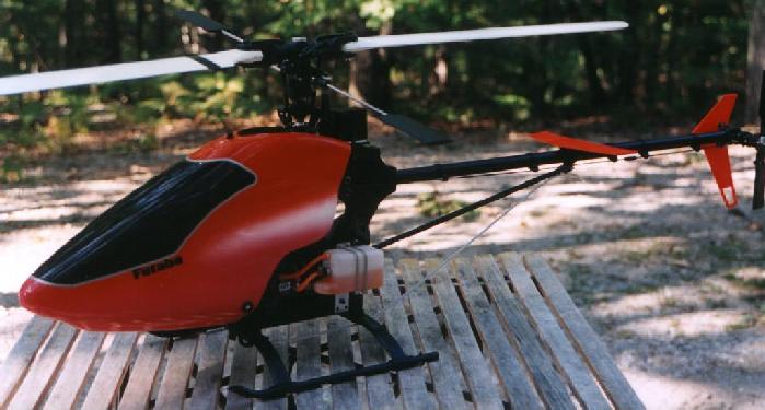

Hi all, i have just bought a X-cell 30. I have flown it before i bought it, so i know it fly's great. I am new to heli's well can fly round in forward flight and the odd stall turn. My question then, i have had a go of a Raptor 30 which i found very stable, a Nexus 30, well forget that, and the Shuttle i learned on. I love my Shuttle it is not as tuff as a Raptor, but is faster round the sky. How would rate the x-cell 30 with the heli's above. Is it worth an upgrade on the x-cell or is it fine as it is.

I have had my X-Cell 30 about a year now and love it. I don't fly 3D but do all the old style heli aerobatics (loops, rolls, etc.). Only mods I put on were the rear servo mount for tail rotor and a good set of composite blades. As far as smoothness goes, I don't think any of the plastic helis compare, especially after the hours start to build up on the machines. With an OS 32 performance is well beyond what I expected with the X-cell's higher weight.
These are my feelings, I'm sure others will tell you the Raptor or whatever is the best flying machine ever. I've tried them all over the years and keep going back to the X-cell.

i flew my x-cell 30 stock for a month before i put an os 50 in it. now it does anything my extreme can do. it all depends on what you want to get out of it, and with that machine there's room to grow if you choose. i'm going to sell mine only because it's easier to keep an extreme in the air if you have 2 of them to swap out parts and there are only a few parts that the 30 shares with the extreme.
