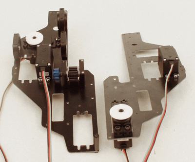

I am building my Quick 30 Pro, but the pictures are totally different from my kit on these items:
Elevator Control shaft-Pro Setup just like Learner on this Pro
has everything else the same as Pro-Thus kit does not have the ECS. It has the setup like the Learner.
Is this normal? Or just manual discrepancies?
I bet it is different between carbon fiber framed versions? This is the Q30 Pro metal version normal?

Culverson,
Yes, this is normal. Originally both the carbon and metal were the same, however now they are different.
One thing though, you may want to flip your rear two swash servos so the horn is facing the other direction, and then flip the arm so it is in the same direction as it is now. You will get the proper alignment for your linkages then.
Sincerely,
Jon Yuhas

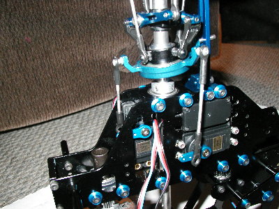

Done, I found it a lil hard to figure out off CD when it was a difference on the Pro version Thnx. I'm not sure Irwin knows this Stephan but your great attitude and mannerism of always trying to help out makes you a great asset to this hobby & H&H as well. Nice talking to you on the phone! You were a great help.

Good pic on servo positioning
