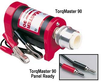

there is a starter shaft one way usually connect to motor with a hex extension on a 12v motor called a starter hooked to a 12v dry cell battery turns the motor over the same way u start your car
2 pressure line from exhaust to fuel tank pushing fuel toward carb

Starter motors, just like the ones for airplanes, are used to start helis, as Skyad said. They are big and torque real well, off of the 12v. The actual mating of the starter to the heli depends on the heli, i know mine uses a 6mm hex, some use a 5mm hex, and i believe some use cones (just like airplane propeller cones).
So you need a starter, a battery for the starter, and a adapter to mate the starter to the heli.

Starting equipment (you need a 12 battery to run them). Thunder Tiger sell a complete field box if you want to go that way, or you can buy each peace individually.

Some drills don't spin fast enough to start engines. Some might, but it all depends on the gearing. Voltage isn't enough to know if it will work, as many drills go for torque over speed, and speed i think is more important to start a engine.
If it works, good, if not you are going to have alot of frustration trying to start it with a drill.
