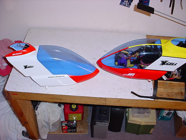

Gonna shoot the final trim coats on the X-Cell 30 glass canopy today.

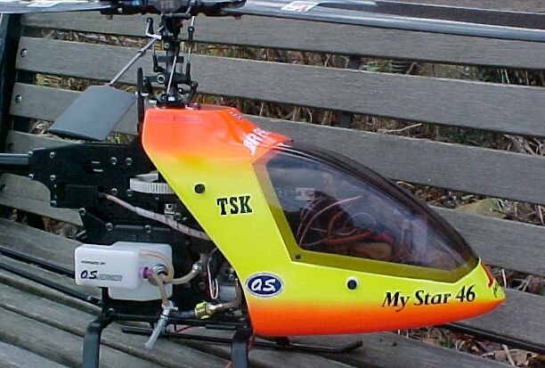

itsindilas
I have painted those type bodies.
Scuff up the surface with fine sandpaper and wash well with dishwashing soap and water. Spray it with an flexible bumper adhesion promoter and then a flexible bumper primer. You can fine these items at most auto parts stores. Be sure to read the instructions on the cans as some limit the amount of time to dry before putting on another coat.
I then paint mine with Krylon fluorescent yellow and orange paint. I just fade in the two colors with the spray cans. I then put on the decals I want and clear coat. I use Minwax clear gloss polyurethane. I don't use the type that says on the can "clean up with water". I had bad luck with it getting sticky and coming off with methanol. I haven't had any problems with the solvent based poly yet. It will take on a little bit of an amber tint so if that bothers you have it clear coated at an auto body shop.

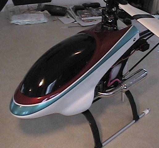

I would say spray PPG. Its the best . Very High pigment and you can tape or clear after 15 min. If you live in cali, sorry its been declared cancer cousing agent . What hasn't?

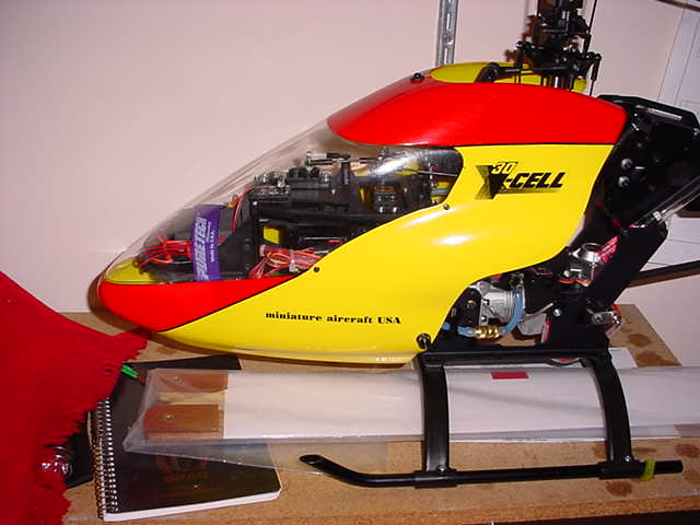

Here's a glass canopy I just finished, using an airbrush and automotive lacquer. That stuff is SOOOO easy to work with and just about idiot proof once you get your air mixture adjusted right.
The clear coat was shot by an auto body shop detail gun; if you are into painting canopies, it's a REAL good idea idea to befriend someone with this equipment. The clear coat MAKES the paint job, in more ways than one.

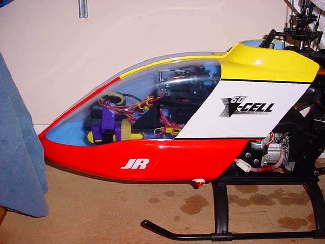

Here's another one, with the same techniques and paint (didn't have enough white to do the 30 canopy).
This is the standard MA Lexan canopy. They are easier to do than the glass ones; no pin holes to fill, etc. Just scuff it with 2000 grit or a ScotchBrite pad.

Looks nice Steve,
Did you paint it from the inside? I did a Lexan body for a friend like that and it looked great. No worry about clearcoating it either. I've done the same with lexan car bodies.

Clear coating is easy. I use a badger 400 touch up gun. Make sure you have optimal conditions, 70 deg F and no dust. Lay the first coat on light, it will look like a mist covering. Wait 10 minutes and lay the next coat on until it turns clear then stop.
This for PPG strato clear DCU2082.

Below is an interesting comparison; I hope the digital photo can show the difference between the canopy on the right, which was done with automotive lacquer and clear coat, and the canopy on the left, which was done with Top Flite LusterCote from the spray can (clear too). There simply is a world of difference.
The spray can hobby paint gave okay results; I'm not ashamed of it. But it certainly won't turn any heads.
That airbrush is a BIG pain to set-up, clean, etc. But the end result is worth the effort. It's only drawback is volume; it really doesn't put out enough paint for a good-sized project. If anyone is thinking of getting into this seriously, a quality "detail" gun should be your first purchase. This is bigger than an airbrush, but smaller than your standard full-size spray rig.
