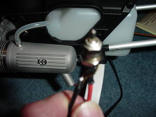

I have a Raptor V2
Where do I attache the end of my remote glow plug,,, I have enclosed a picture... any help or advice will help a great deal...
I also have a fueling valve I would like to fit to make refilling easy...
Should I get a small metal plate and attach the fuel valve and glow plug to it
I know I am a pain tonight but I have just about finished

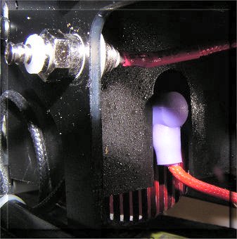

This is what mine look´s like!

Yep you can mount the remote glow on one of the frame to engine mount bolts - thats what I did
as for a fueler valve the only way is a small plate like you said - I tried it and didn't like it so I did without
Nick

The red cable goes to the glowplug and the black goes to one of the enginemount bolts as nickwap says.

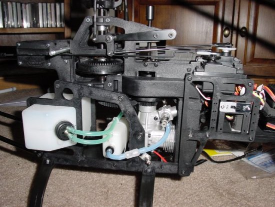

Mine is the Ace remote Glow from Heliproz... $6 I think.
