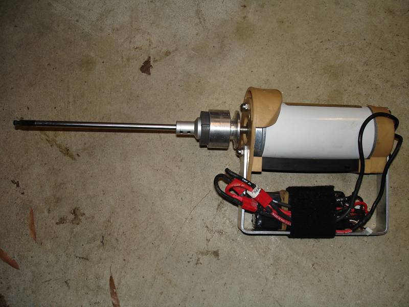

After several different starters and batteries, the best setup I've found for big glow stuff is a Dynatron wired up with 2 11.1v Li-po batteries for 22.2v and 2100Mah. It's good for .90 size helis and big glow airplanes. I have 2 OS 1.60 2c and it will crank those better than a regular starter cranks a .40. The charge will last about 2 weeks with everyone at the field using it because they're tired of trying their little starters.

Thats interesting. I have a couple of TP 2100's I don't fly, I wonder if I should try that. I have a dynatron but the batteries are shot and I haven't bothered replacing them yet.

BH, That's what you need, some old puffed out Rex batteries works well. These were some 16c's that I didn't have much use for. The charge does hold up well so it's one less thing you have to charge everytime you go to the field. It's cranked over a 40cc gasser with no problems before. I came to this just because none of the 12v hobby batteries put out enough amps to start anything. That Mavrikk starter that they claim will start a .90, they left out the part of it will only start it once and toast the batteries doing it.
