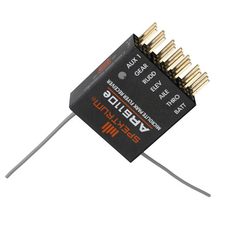

I just recently purchased the DX7 Spektrum radio and some ar6110e receivers.
For the life of me. I cannot find anywhere a reference to the connections. Yes it says right on the receiver.
I cant get my plugs correct on it.
450 heli. 120degree swash. Coming from a hitec 6 channel to the ar6110e 7 channel.
Can some one tell me which ccpm, ail, ele, servo is which. left side versus right side. I have 3 servos to plug and i cannot get them series correct..

I would imagine the elevator servo will be the front one on the swash. As for the other two just plug them in and see if they tilt in the right direction with stick input.

1320, Thanks that helps. But the servo is in the rear of the swash. So knowing the center front / rear servo on a 120 degree swash is the elevator. Side One is the Aileron that will plug in the Aileron jack and the last one / Pitch will go into the 'Gear" connection.

Edit - Got it, Cant use the Gear - Need to utilize the Aux1 put Aux on INH in radio- It works Now
Im ending up with pitch on the gear switch and Aux doesnt want to work either,
Currently I have:
BEC, Motor into - Throttle
Rear Swash Servo - Elevator
Gyro - Rudd
Left Swash - Aileron
Right Swash - Gear or Aux Neither work.
