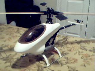

I am 100% new at this whole Helicopter Hobby. (spur of the moment thing) I found a great deal on e-bay, so I thought, so I bought it. I think I have a Raptor 30 V.2 but I'm not sure. I'll send along a picture if it helps. It appears to have a TT PRO 36H Engine and I'm wondering if you have any suggestions for fuel types and battery packs for the servos? Are there some kind of Main Rotor Blades I can purchase to learn to fly with. I also got a SkySport 6H Raido with the chopper, any good? Thanks in advance for any help.

I cant tell for sure but I dont think that is a V2. I dont think they sold the V2 with the 36 as a ARF. The radio will fly your heli. As far as fuel you can use most heli fuels with 15 to 30% nitro. You should use a heli fuel, they contain more oil for longer engine life.
As far as battery you should use as least 1100mah 4.8 volt.

Thats the V1 body. Still a good heli, the most popular 30 sized, so it is easy to get parts for. i have heard the engine is so so, but if it works, what the heck, enjoy. you are off to a good start. you can keep flying that same heli for a long time, there are upgrades to stuff up to an OS 50 into it (very nice and powerfull engine) bigger blades,,,, you might have that heli for a while, you did not waste your money on it.
The simulator is a must, helis are a chalange to fly. The good news is if you crash it is rare that it will cost more than 60$ to fix and takes only an hour or so to repair good as new.

cdy64, take the canopy off an post some closeup pictures of the insides and the tail rotor assembly. We'll be able to say for sure what it is. Also, you'll want to get the stock decals or some adhesive neon tape to put on the canopy. It will really help with visual orientation in flight.

As you can tell I'm still learning to use this site also...UGH ! I don't have very good pictures, but I'll do my best with what I have. Hey, Thanks guys for all your HELP and Info, I will take what I can get, and the price fits my budget...LOL

From the canopy pics, it looks like a V1. I have the V1 and really like it. Crashed it once due to dumb thumbs (still learning too), but is only cost about $40 and an hour to repair. If you bought it used and/or haven't seen it fly in action, most of us will advise that you find an experienced heli pilot to help you set it up. At the very least, go to www.raptortechnique.com for TONS of great info. You'll get lots of help here too!
IMO, If it's not set up already (you have not witnessed it flying perfectly), I would spend a couple nights tearing it down to make sure everything has loc-tite that is supposed to. The assembly and set up instructions on raptortechnique are great.

The 401 gyro recommended is great. You might find that you want more radio. I am pretty sure that is a V1 heli, but it is a good heli. As stated, get the sim. Saves you the price of the sim many times over. Will pay for itself in the first day. You will like the heli. It is a good one.
