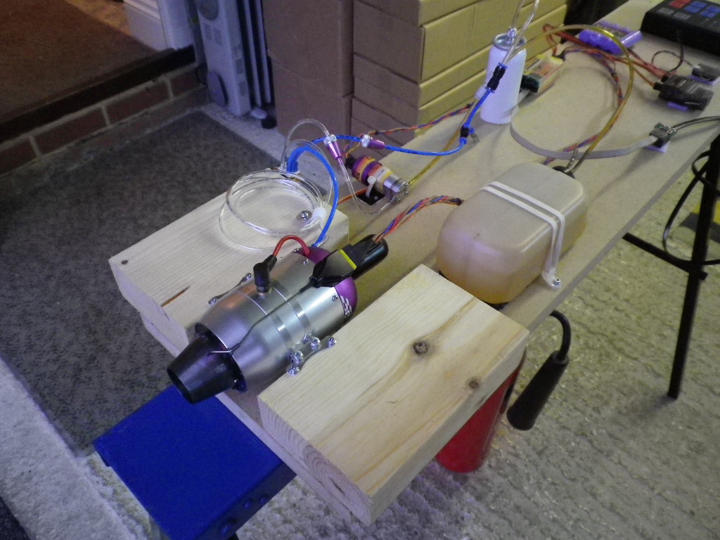

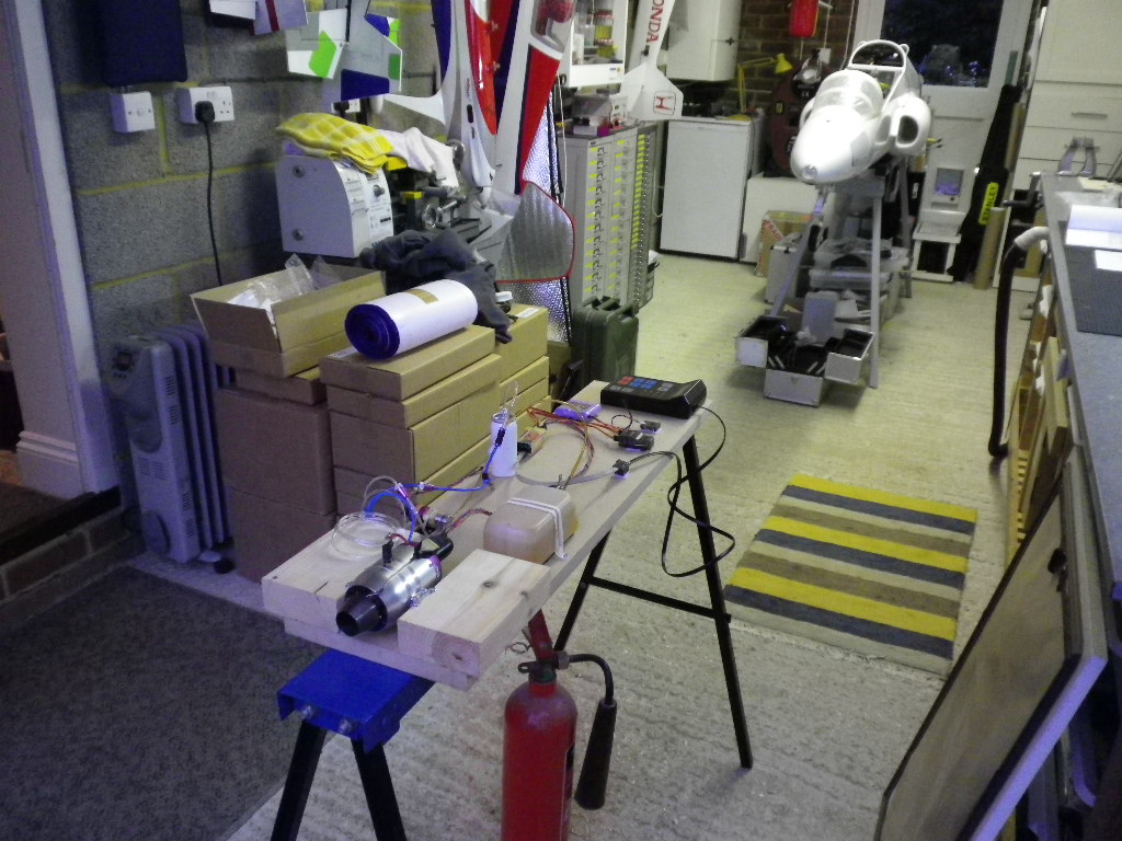

Ran up a friends P20 tonight just to see what this little gem can do, will be fitted to our prototype 'Stinger' jet. Video will follow shortly..

Marc
With the glow plug you need to use the coldest (thick element) one you can find and only pull out one coil (not the usual 3) You can almost fold the last coil open and it will catch. I also dropped the plug voltage from std
Dave

pretty cool!!![sm=thumbup.gif] damn fuel pump is almost as big as the motor LOL
"Stinger Jet" good looking little bird
