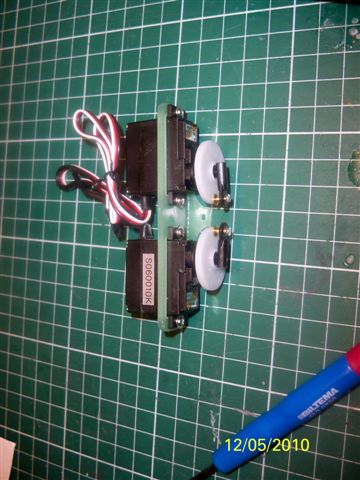

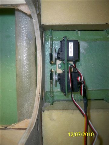

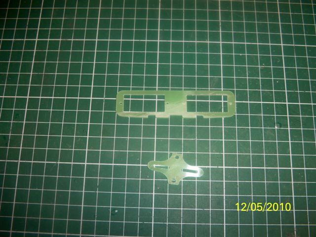

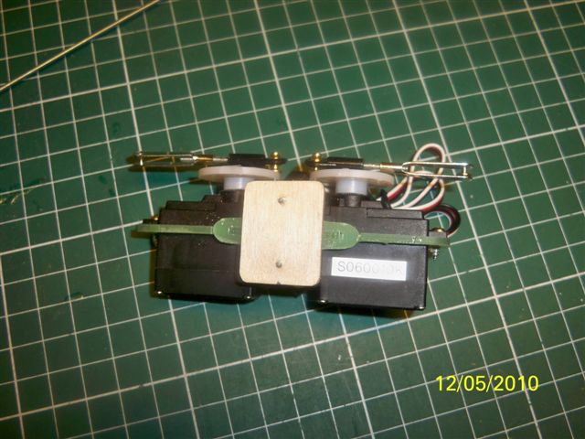

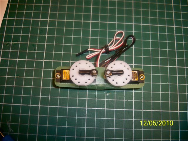

Today I have made the servo holder for the hatch servos. Glued it in . It´s removable if necessary. I use Hyperion Atlas 13 TMB programed to 180 degree travel.
[youtube]http://www.youtube.com/watch?v=tUzE55O0IWU[/youtube]

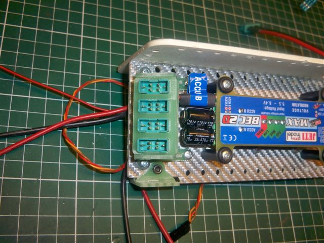

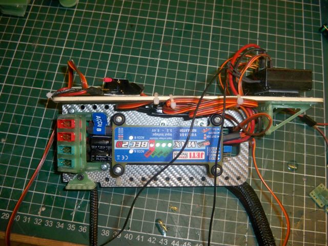

I have made a RC tray for 18 chanel JETI 2,4G receiver , JETI MAX BEC 2D, air valves , JETI speed sensor , JETI electronic switch. and possition light unit.
